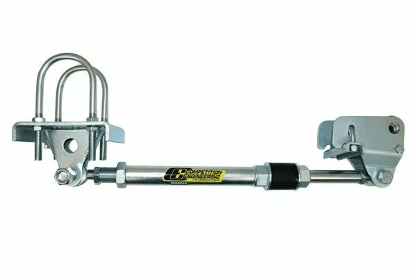

Looking to buy - CE-C2093 Competition Engineering Traction Bars, Slide-A-Link, Steel, Mopar. Can't seem to find them anywhere except at VPW in Australia for $602.00.
Are they discontinued?
Didn't want to use Cal Tracs because I have been told they are noisy for the street.
Anybody have any suggestions on what you use or a good traction set up?
Don't know a lot about the subject. been advised that I need to be aware of spring wrap and damaging my driveline and tranny.
