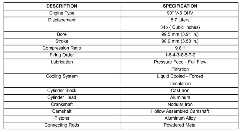

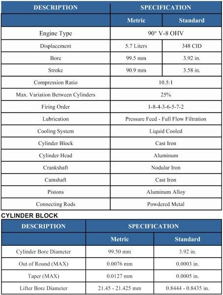

Good morning everyone. Can anyone explain why there is a difference in compensation ratio between the 03-05 and the 06-08 hemi engine?
Thanks for your knowledge. This is the 05 and 07 specs from Alldata.
Clint.
I could be wrong but I believe it is the heads although I seem to remember something about a piston change in there as well.
The engine features a displacement of 5,654 cc with a 3.917-inch bore and 3.578-inch stroke. The unit is housed in a cast-iron block and it comes with a cast aluminum alloy for its head composed of 16v OHV design. The compression ratio of the engine from the 2003 to 2008 VVT model years was 9.6:1.
The 5.7 Hemi VCT follows the format of the former but with a few tweaks, especially on the cylinder head in order to improve airflow. It revises the compression ratio of the engine to 10.5:1 between 2009 and the present model years to augment thermal efficiency leading to an increase in mechanical energy that further translates to more horsepower and torque values.
