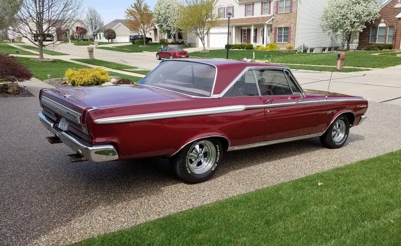

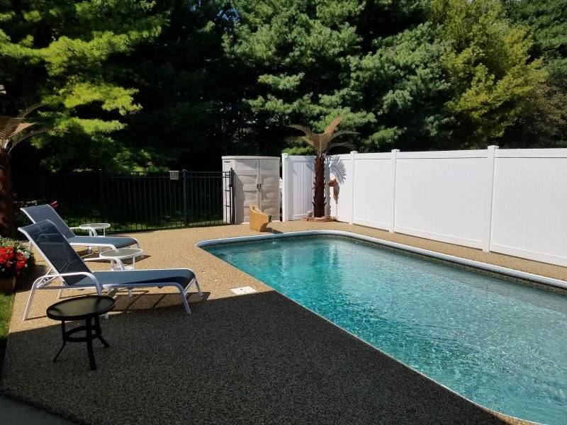

Years ago I had a few cracks and stains left from the previous owner. They came out and ground all the edges down about 5/8 inches including the cracks and carbon fibered the cracks. You pick out the color of pebbles you want and they mix it it a portable concrete mixer with a clear two part epoxy. They then trowel it on a 1/2 to 5/8 thick. They did my driveway, front sidewalk, front porch and around my pool.The nice part is, if the concrete under it should crack, they can repair it. The water ran through it and out, rather than on top, less slippery. Stains wiped up and it was shiny. It did need to be sealed every 5 years with a two part clear epoxy THEY rolled on, you're not going to get this stuff at any hardware store. I chose this way for one big reason, concrete comes with two garranties, no one will steal it and it will one day crack. I don't do cracks, so to replace it and for it to potentially have another big crack in it again would not make me happy. It cost about the same as replacing the whole driveway without the big mess of breaking it up and hauling it off and this way if it should crack, it's a few hundred to repair it and it looked great.
