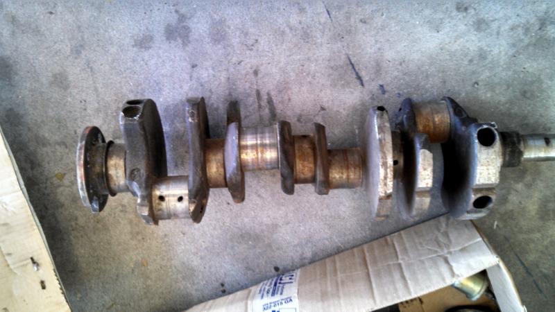

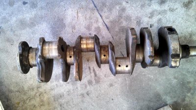

This is the crank that came with the motor. This is my first time building a mopar, so not too familiar with a lot of stuff. I bought the motor separate non running. I also have the six pack dampner already also.
It is a steel crank, but what is the casting number? As far as the rods go, skip the 440 source rods, get a set of LY rods, resize them, ARB bolts, and you will be fine. After that, either keep the 6-Pak rods, or sell them.
I do not recall seeing a casting number on the crank when I took the pics. Where would that be at? The crank and motor are not with me at the moment. Does something look off with it?
