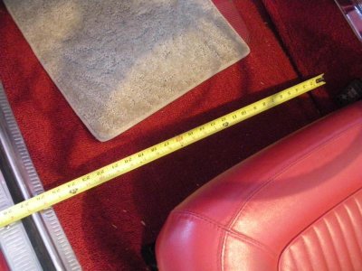

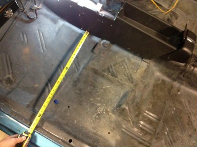

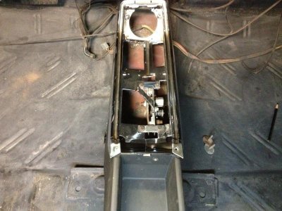

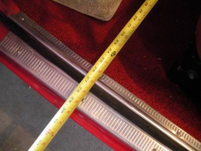

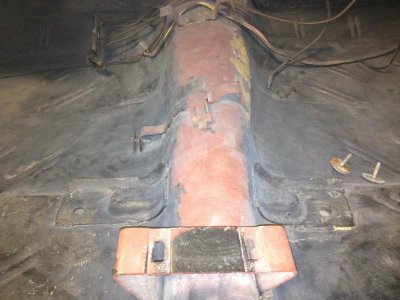

I have major sheet metal work done and I'm not sure the console brackets are welded in the right position. They just don't seem right. Is there any measurements available or does someone have pic's that would be helpful.
The measurement shown is 27" from lip at the door.

Can you show me the bottom of the dash with the console, also were all the brackets redone or just one or two?
I can take some pic's and post tomorrow eve. It looks like all were welded back in and just don't seem to match up from what I can tell. Not sure if it is centered.

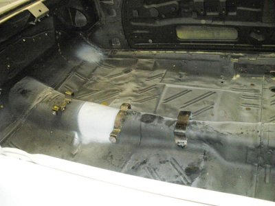

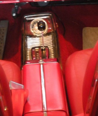

I just put brackets in my 65, and i was looking at another 65 floor w/brackets... the console is slightly offset to the drivers side. I thought it was strange, however i then looked at a complete 64 and sure enough the console is offset. I have pix of where i put mine.
Console
Didn't measure, bu there is a floor pic

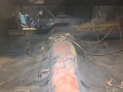

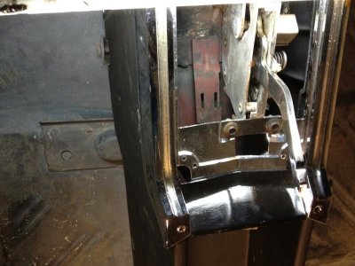

Here is pic's of mine
Mine seem bent up compared to yours. I thought they were but never know,

Here are some pix
As you car see the console is off center towards the driver seat

Thanks 65affair, looks like I just need to tweak the bracks alittle to match the holes. Placement looks about the same once installed.
