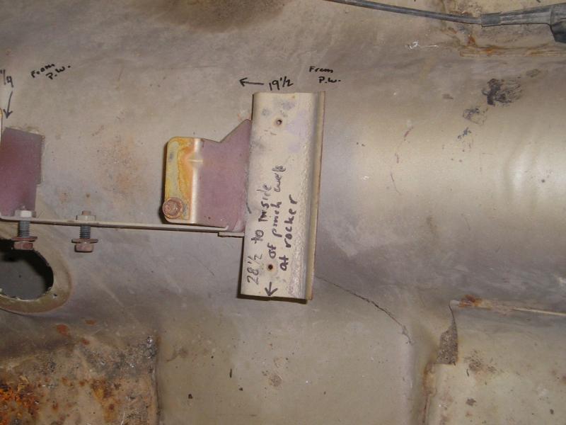

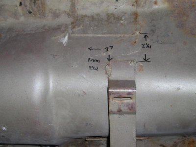

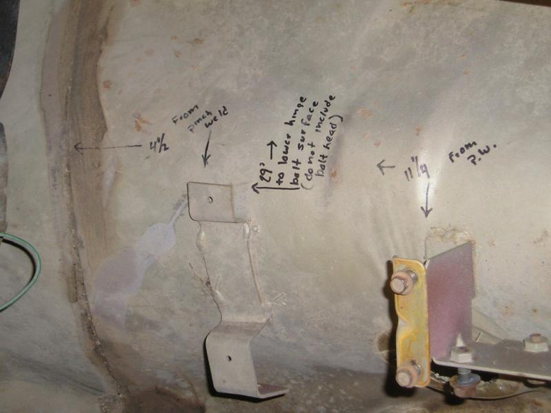

Does anyone know of a template (or at least measurements) for welding the automatic console mounting brackets to the floor pan of a 69 Roadrunner? Any assistance is appreciated!
Here are a few pictures from a '68 auto, should be the same.
Many, many thanks! This is going to be very helpful.
