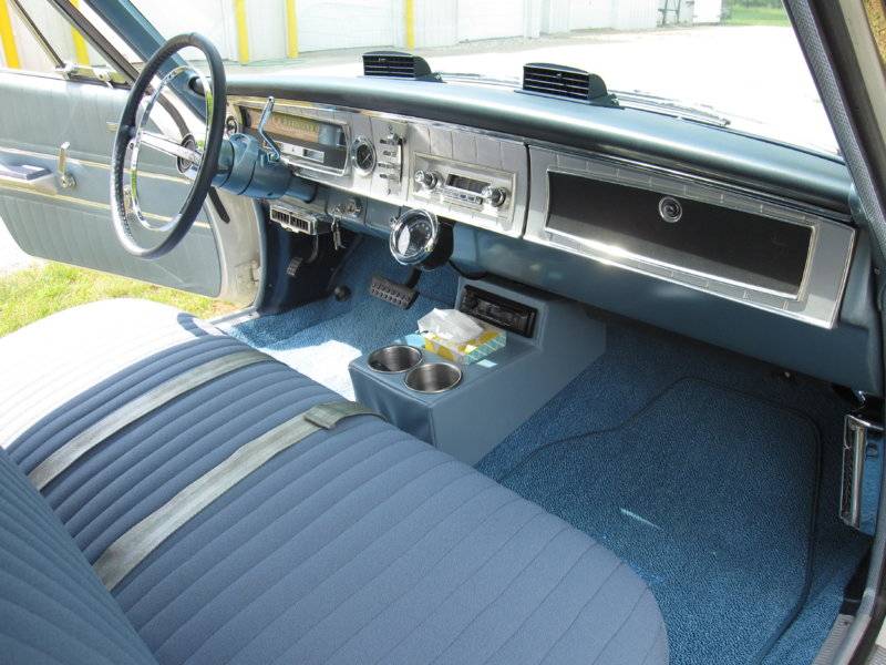

I fabricated one for my 65 Coronet. Used 1/2" MDF board and the wife sewed up a cover for it.

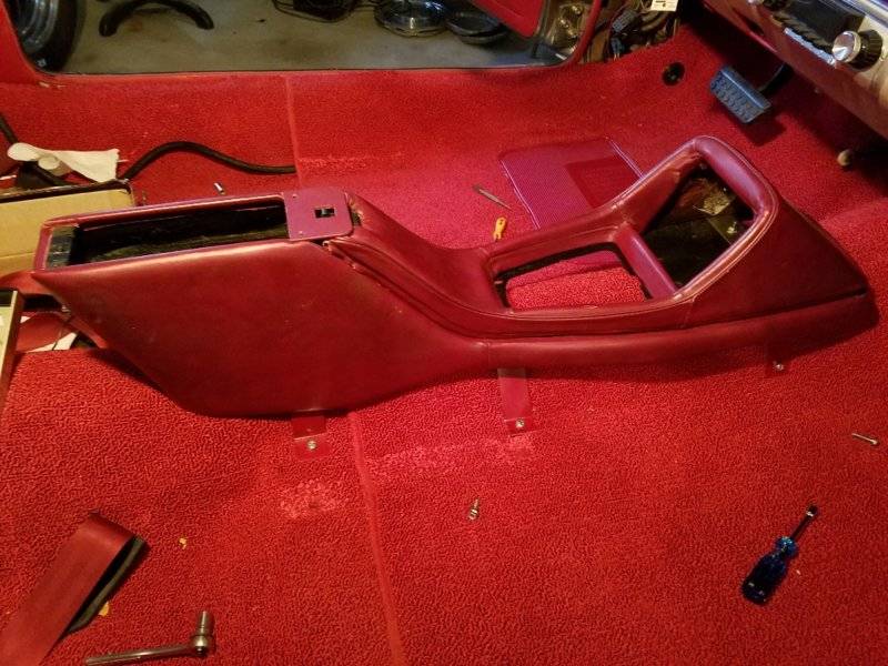

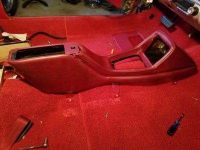

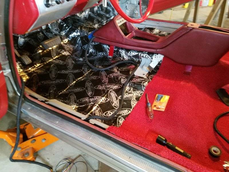

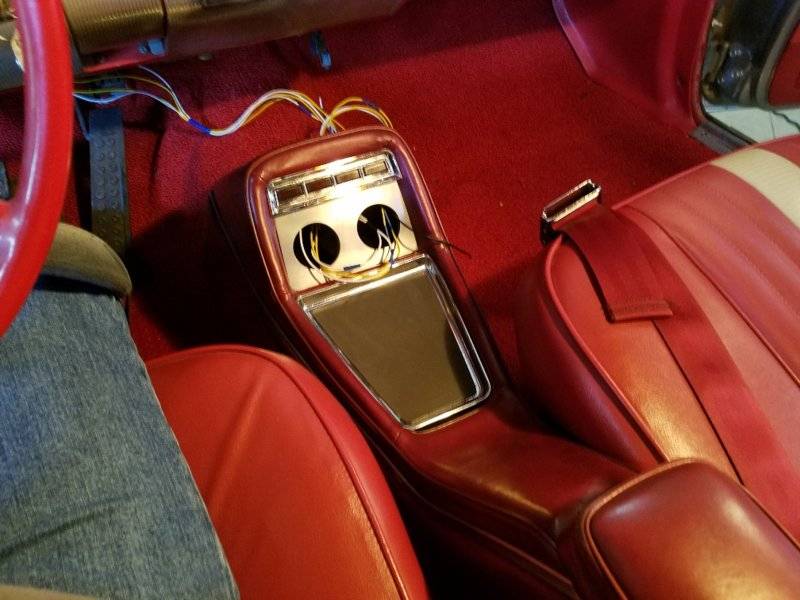

Installed a console from a Lincoln in my '63 Fury earlier this year. I had some decent gauge sheet metal to fabricate the brackets, rivet, drill, bolt, wire up, etc. The hump isn't dead center in the car so had to accept a slight offset but I read in a recent post just a few days ago this is common.
Console 1 pic Plymouth.jpg Ply Console Bld wiring.jpg Ply Console L.jpg Plymouth Console Setting.jpg
If you would like more photos I can send along. It was more work than I thought; but this leather console I got at a swap meet for 10 bucks some years ago has a light bar so I rewired for brake and turn signals, headlights. A buddy fabbed out the aluminum (scrap from his shop) for extra gauges and cup holders. Also had to make up a block underneath the box to level it out a bit and some drilling out for the wiring harness. Painted the leather (Herb's paint) that was dark maroon to mate with the interior red and worked out pretty well for a better match. Again a great thanks to those on our forum who had some great advice to help me complete this!

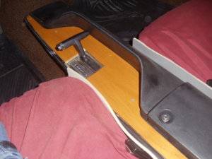

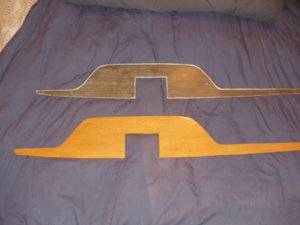

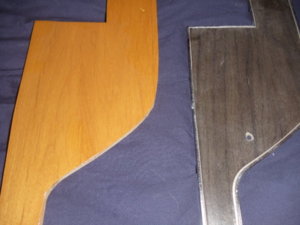

In my '72 SSP I used a factory console but replaced the faux wood grain overlay with a real slice of alder wood.
