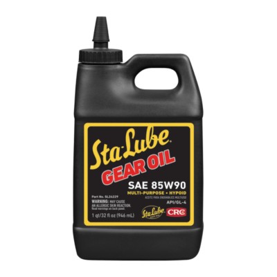

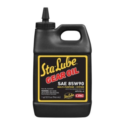

As recommended by Brewer's Performance....
