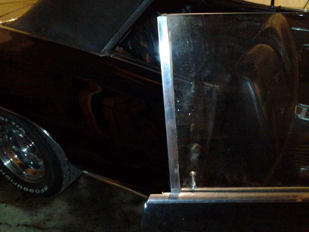

I have a 1969 coronet convertible and am trying to figure out if I can use hardtop glass.I have what I believe to be original pass. side glass that I matched up perfectly to hardtop glass.? Am I missing something or? Anyone have a breakdown of what I need for the glass and stainless? A pic would be great.Thanks
Now I am wondering if the glass was switched out before I bought it. One window was in the trunk. Other window was down.HMMM?

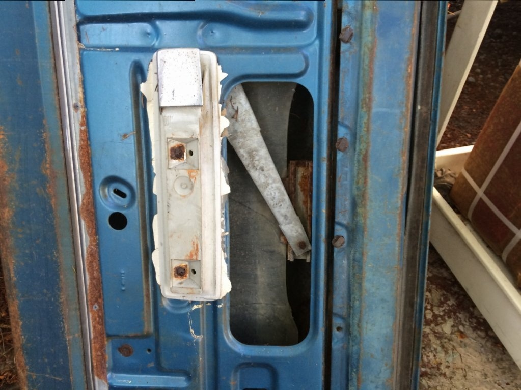

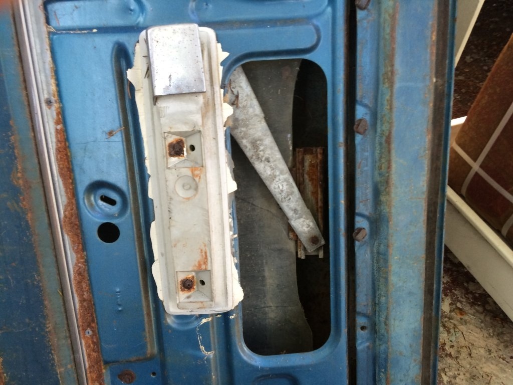

Is far as i know, the glass is different. I need one door glass myself. I parted out two hardtop doors last year and the glass was different. The vert glass has a notch in the middle bottom were is attaches to the mech.
Have any pics of what it looks like?
This is the original door from my vert.

So here is a pic of my friends 1968 coronet convertible door glass.Is this the same as a 1969 as far as this stainless piece?I do not have these stainless pieces so I wonder if I am out of luck on this?Thanks
Looks to be the same as 66-67 b bodies.?

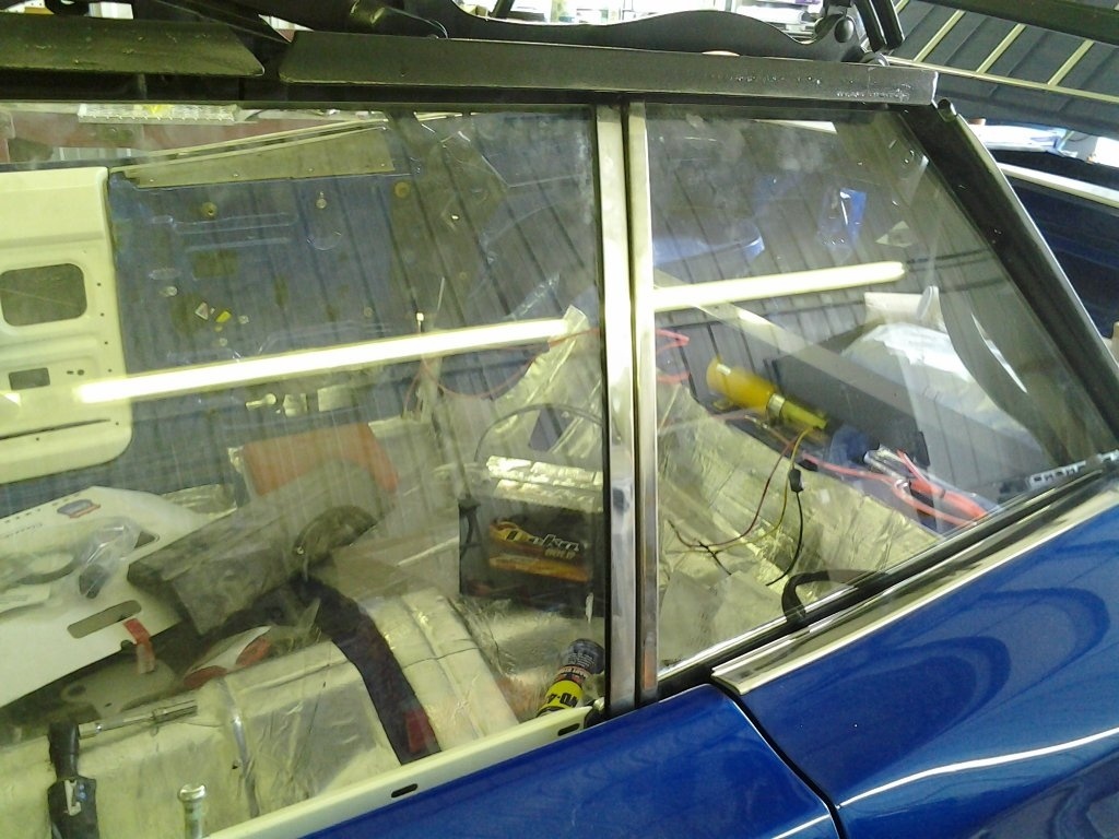

Well the 67 charger stainless worked.:thumbsup:

New glass is correct and fit great. I cannot vouch for the 68 glass though...
Jamie, did the new glass have the same curvature as original..
I never had the original to compare but it has less of a curvature than the hardtop one and matches the quarter window just fine.
