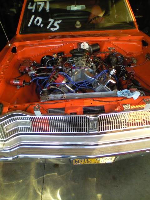

Edlebrock Performer RPM. I will suggest a 125-175 hp nitrous shot to get you well into the 10's. It's cheap horsepower.
On my 3000 lb car this is what it took.
Zero deck 440 +.040
Hughs .590 lift cam
M-1 intake
Holley 750 carb
Complete MSD ignition
tti 2 inch headers
Eldelbrock 84 cc heads milled down to 75 cc and flow 42 cfm over stock
4.10 gears with a spool
28 inch 12 inch wide tire's
Very well built trans
3500 stall
It takes a lot to get into the tens not using n2o
Did not use n2o on the car posted.
This is a pump gas street driven car.
10.71 in the 1/4 threw mufflers.
