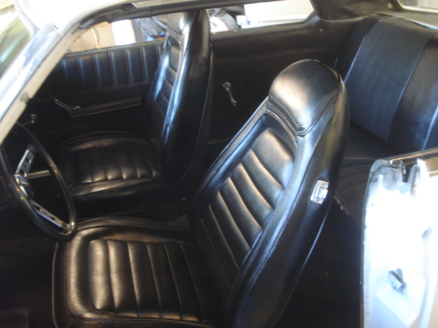

i just dd this to my 1963 dodge 440, late 300 buckets, very simple, driller 4 holes, adjusted the inner sliders all the way down and the outter all the way up... they ook pretty good,,, but i like the bench look better, i'm swapping back this weekend...

They do look sweet in there.
