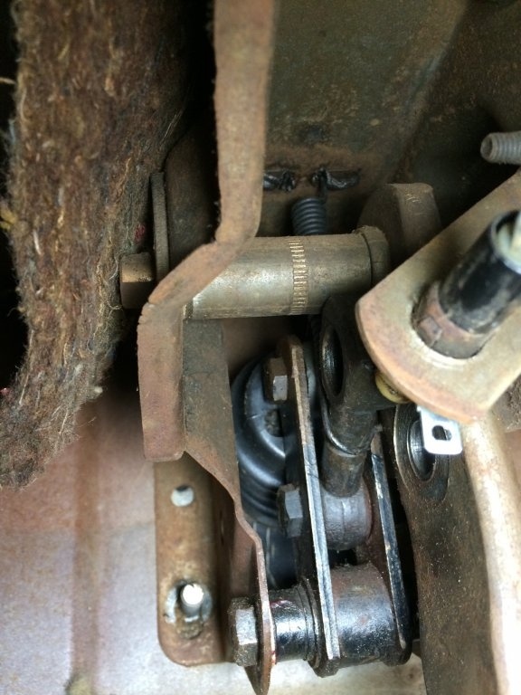

Just happen to have a picture, I'm in the middle of a project so the brake pedal is detached. Note the spring as well.
Yes. Looks like Brewer's has what you need. See link.
http://www.brewersperformance.com/products.asp?cat=279
