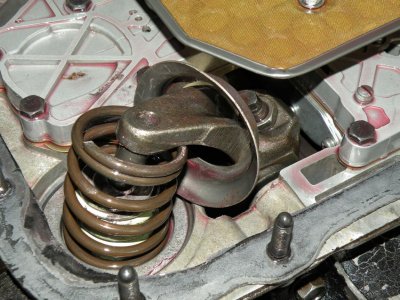

sounds like your converter is draining back. once you start it up put it in nuetral right away and see if works better. if not i'm guessing a rear servo seal is going bad and your line pressure is low.ask me how i know
x2
i would also have the bushing in the front pump replaced,.when tolerances get a bit loose,.fluid drains back into pan & pump has to re-fill the convertor ect..ect..
well good luck with it---Bob
p.s.-the bushing in mention is the convertor hub,.area--its pressed into the front pump--i think its a copper/brass type bushing...
