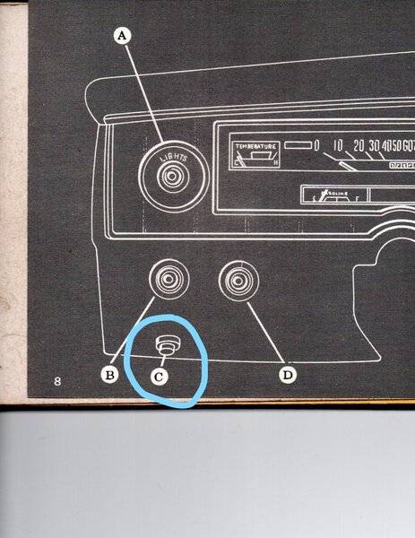

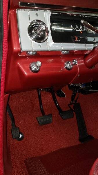

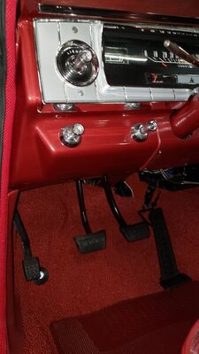

Just wondering why my Coronet did not have this warning light? There was no hole for it when I blasted the dash. I see the owners manual shows it. Would it be the 500 model only not the 440 models? It would be nice to have with a 4speed car?

They weren't standard till 67

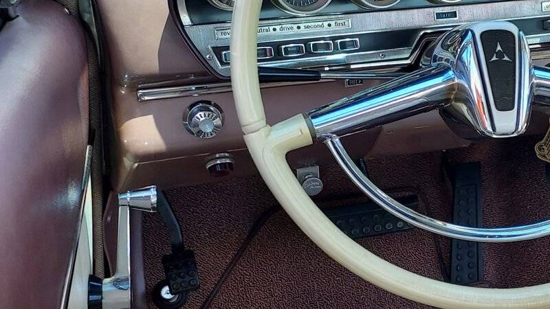

My 65 Belvedere 2 four door and 64 Dodge 440 have them.
If your car had the optional light package.
That came with a glove box light,trunk light and possible reverse lights.Not sure about the reverse lights.

My 1964 Polara has light there. It might have been an option, or part of a package, as some one else suggested. It would be easy enough to add, if you find a parts car with it. There is a switch like the door jam interior light switch on the E-brake pedal assembly. It takes key-on power. You would have to cut a hole in the dash for the indicator light. I find those step drills handy for that type of thing.

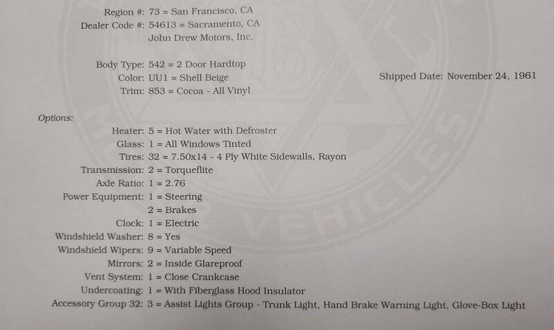

In 1964, the 335 coded Light Package included: Parking-brake Warning Light, Glove-box Light, Trunk Light.
The package was optional on all Dodge and Plymouth B-bodies.
It retailed for $11.85
I don't know if the above applies to the 1965 models.
Sounds like an option per rarefish ..... not sure if I want to drill into a restored dash. Thank you guys for the information.
