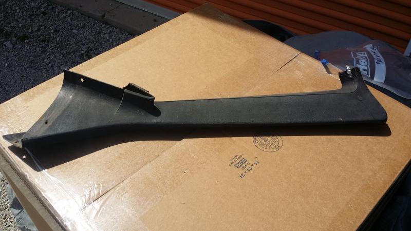

This was removed from a 69 coronet. Will it fit a 69 super bee? Thanks 20140408_132734.jpg
The dash boards are different. Wasn't sure if the ends were.
