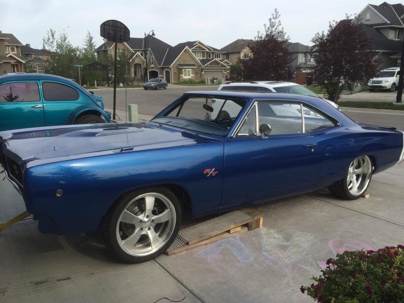

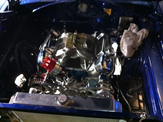

So, I am hoping to have my car done soon... That's what I have said for __ years now...
She's a #'s matching 1968 Coronet R/T. 4 Speed. There has not been a single part that has been reused... 4 wheel disc, RMS front and rear suspension, 512 stroker.
Hopefully, I get to fire it up before the summer ends.

A bit more about the car:
Color: Viper GTS Blue

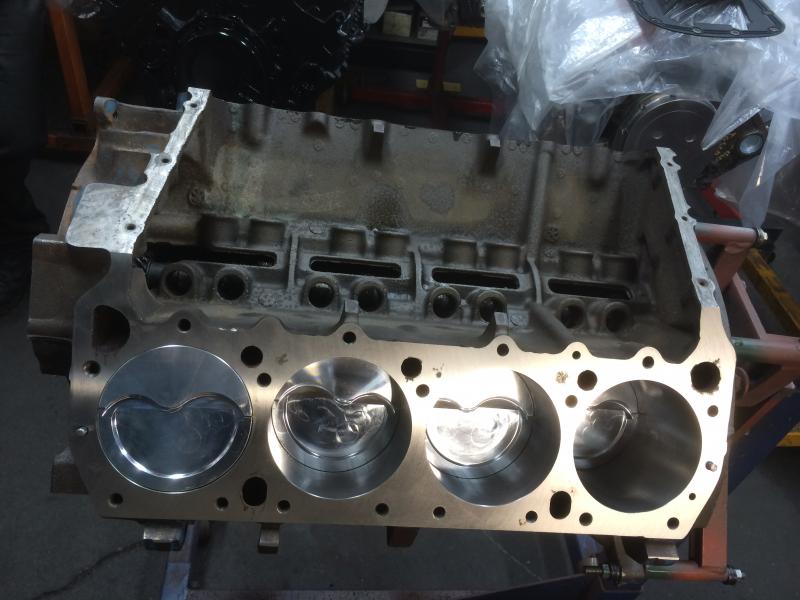

Engine: 440 stroked to a 512 (505 .30 over) 440 Source
Heads - 440 Source Stealth (upgraded keepers and seals)
Cam - Lunati Voodoo 60302
Carb - Quick Fuel 850HR
Intake - Holley Street Dominator
Distributor - MSD Plug and Play
Oil pump - Melling HV pump
Fuel Pump - Carter Mechanical
Oil pan - Milidon circle track
Pulleys - CVF Racing
Water Pump - Mopar performance
Champion 26" radiator and electric fans
Brakes:
Hydratech Hydroboost
Wilwood Master Cylinder
Wilwood 6 piston front
Wilwood 2 piston rear
Wheels/Tires
Bonspeed Huntington
19x8.5 front (4.5" BS)
20x10 rear (5.5" BS)
Michelin Pilot Super Sports
265/35/19
285/30/20

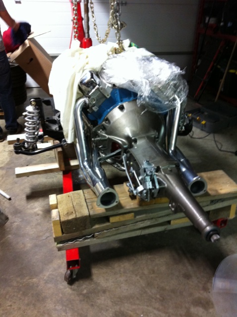

Suspension:
RMS Alterkation
Street Lynxx 4 link
Rear End:
Stock Dana 60 (3.54)
Green Bearings
Interior:
White door panels and white seats (Legendary)
Dark Blue Carpet
Stock Blue dash and pads
