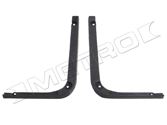

I got mine from Mopar999 on ebay.
Looks liek some other are carrying them too, this is a good price I think I paid $70.
http://www.profitautointeriors.com/products/gb/Dodge/0/Polara/Rear-Bumper-Filler-Seals--Fits-2--4-door-hardtop--convertible-and-sedan--Pair/5413523/79048/BG-101-B.html
i see they say 63 64 wonder if there the same on 65s?
I believe a 64 and 65 dodge have the same rear bumper. Good point though prob worth checkingif these work.
Yes, the 64 and 65 share the same rear bumper.

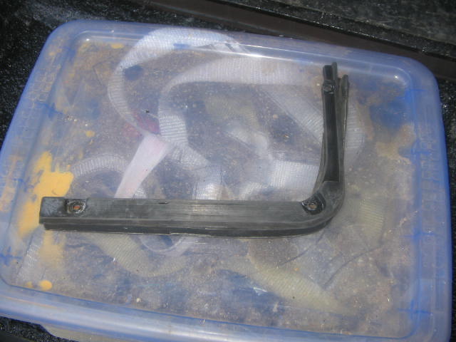

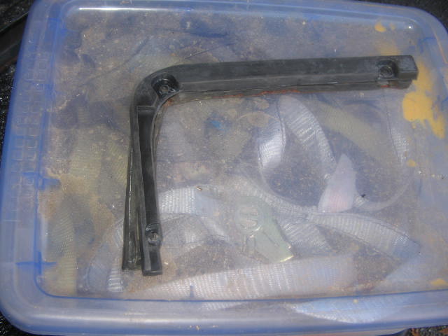

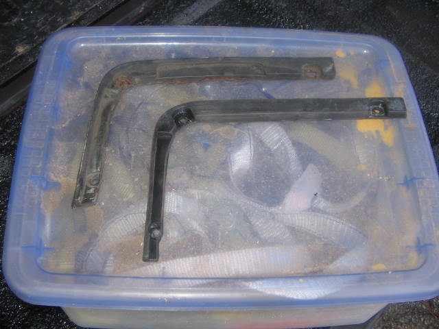

Received the parts today. Very close, but a tighter curve than my original '65s. I think that I can cut from the inside of the curve, at the center screw hole, and they will have the same curve. Like I said.very close, but not exact.
You can tell the slight difference in thes pics. It fit pretty darn well after cutting through the metal backing at the center screw hole, I could open up the radius.
