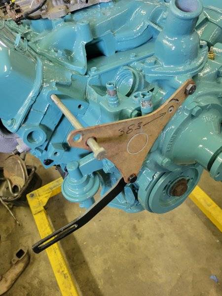

Hello everyone,
Does anyone know where to find the correct bracket for my alternator? It came with the one shown below when we got the car but I want to get the correct one. Its a 65 Satellite with a 74 440.

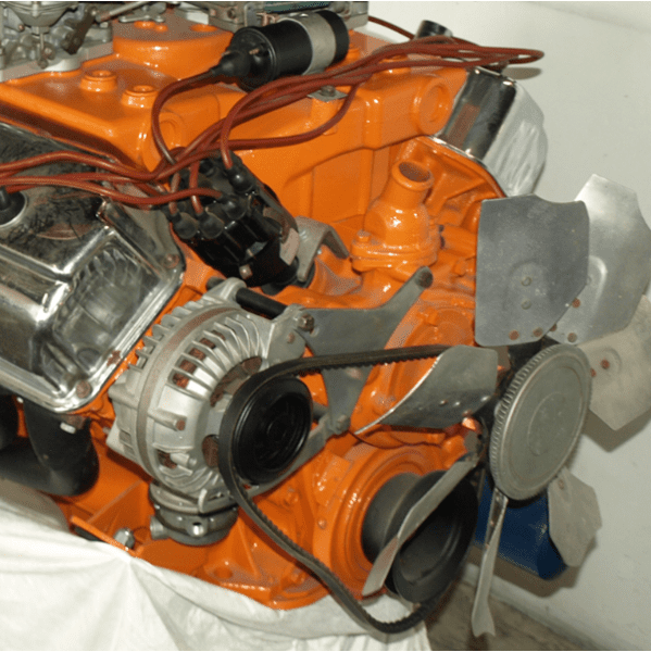

It appears you have the 66 and down early pump, which use the unpainted one on the right.
Disregard the writing on it lol
Does my bottom bracket look right? I'm looking for pictures of engines to see how the alternator is set up but I cant find any with my same water pump housing.

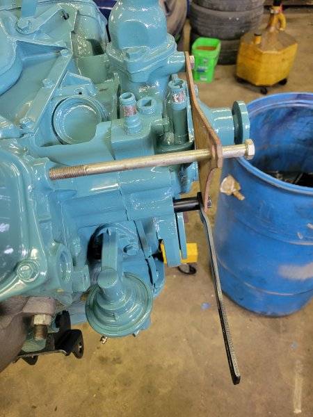

I did a quick mock up so you get the gist.
Never seen one like yours before lol. Your alt is upside down
