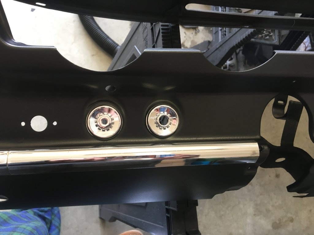

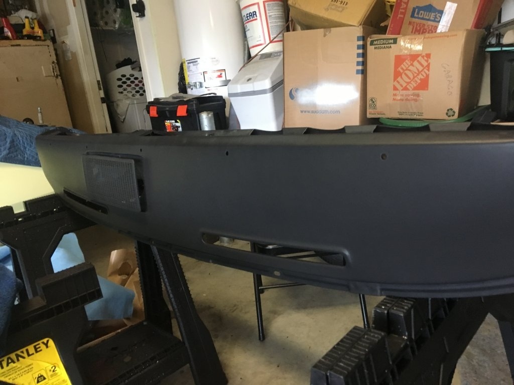

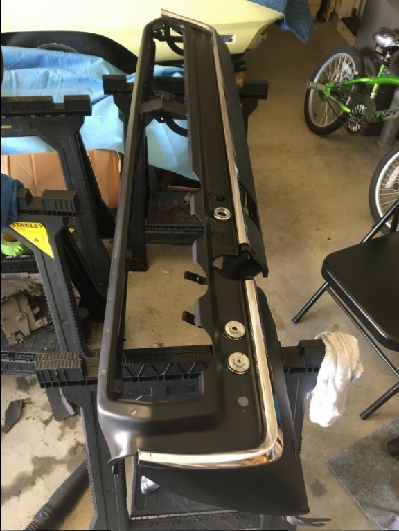

I used Herb's Parts interior paint and adhesion promoter on my dash bezels. The SEM I used on the A pillar trim and kick panels. Installed, you're not going to see any difference.
So than matte is more correct?
This is trim black
