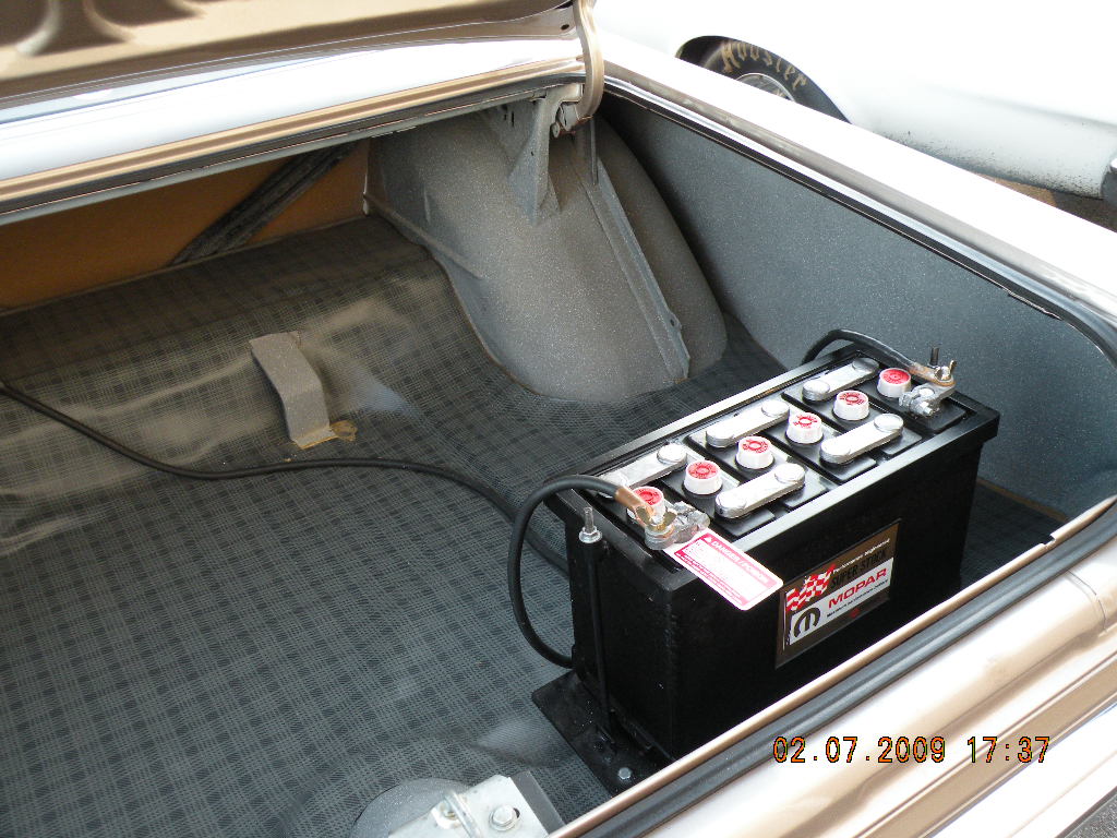

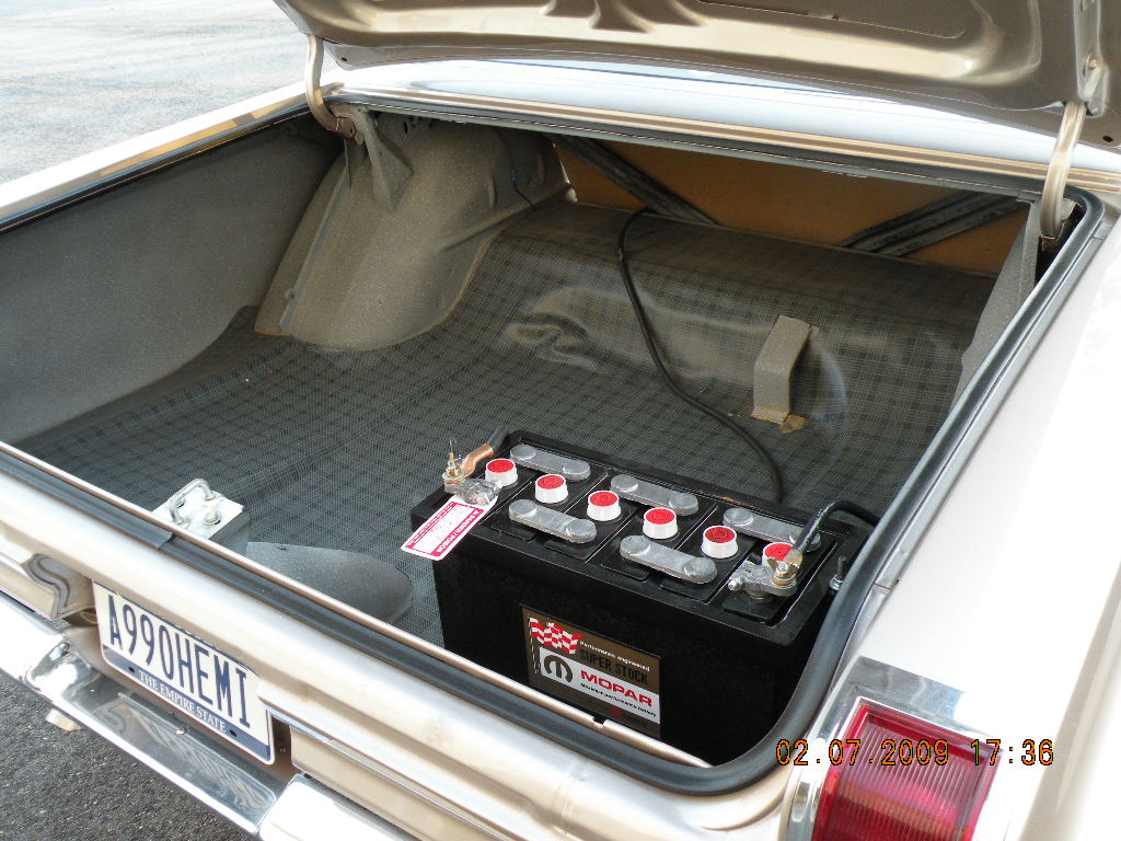

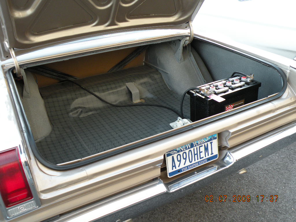

Correct paint is zolatone code dx1734 available from tcp global gray with blue black and white I needed 2 qts to do my 64 dodge
100% correct. thats the correct way to do it.

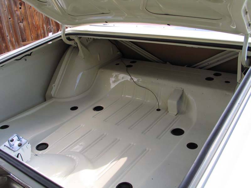

so was it in 64 that they changed it........my 63 dodge is body colour in the trunk?

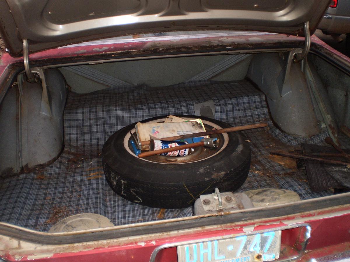

In my 64 Belvedere the trunk was sprayed with the cardboard divider in place.

trunk paint
The divider was installed when the trunk was painted! mostly overspray on the divider though.
