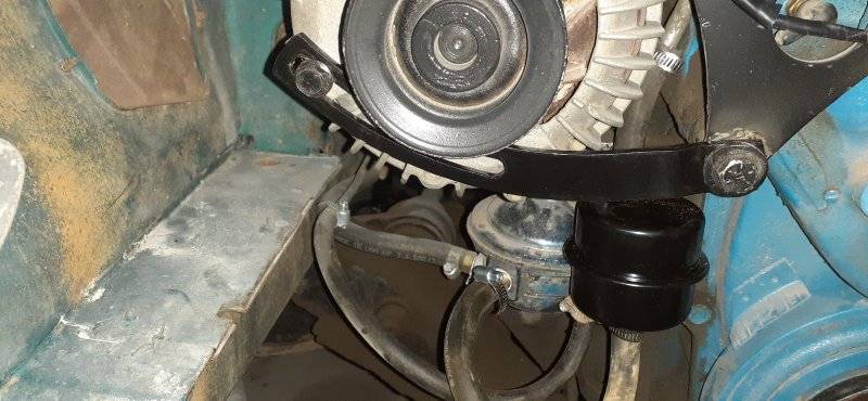

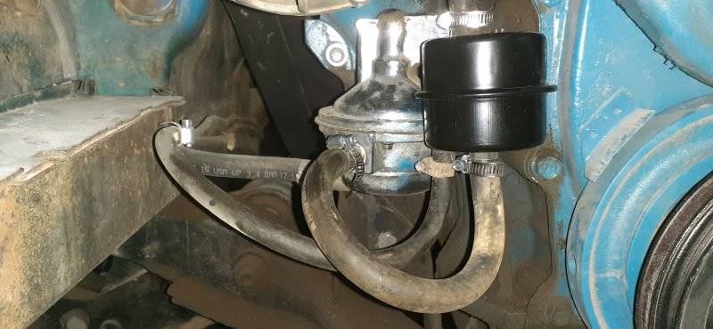

My '68 R/T came with the return line. It is an early St. Louis car. This is before I changed the fuel pump, but it shows the vapor seperator and the return line. The chrome fuel pump didn't work for very long long. The last picture shows the Oreillys fuel pump that I put in recently. I was hung up on the 3/8" line, but 5/16" is adequate, obviously.

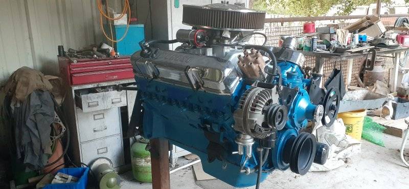

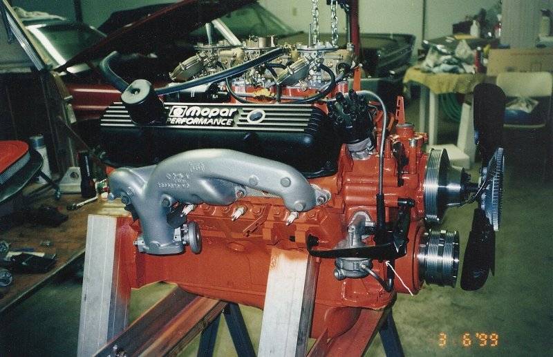

My 1968 Charger R/T came from the factory with the 3/8" fuel line and 1/4" return. From what I remember, only the Hemi and 440 4 speed cars got the larger fuel line for what I believe was to control the vapor locking issue. 440 and 383 Automatics got the 5/16" line with no return. If your car has no return line, it came with the 5/16 line so someone must have upgraded it. Included with the 3/8 line upgrade, the send unit would have had a 3/8" outlet and 1/4" return nipple and the separator mounted on the fuel pump bolt. From what I recall, the separator had a 5/16" inlet and outlet along with the 1/4" restricted nipple for the return line. My 70 440 Six Pack engine got the same set-up. I don't have any pictures of my 68 set-up but here is a picture of my 70 Six Pack engine showing the fuel pump with 5/16" tube feeding the separator. That said, I suspect the fuel pump more than likely came with a 3/8 inlet provision and 5/16 outlet but I have no proof of it. Just speculation. I don't remember the Carter number on my 6 pack engine but it has the 3/8" inlet provision so you can use either the 3/8" or 5/16" adapter. Hope it helps.
