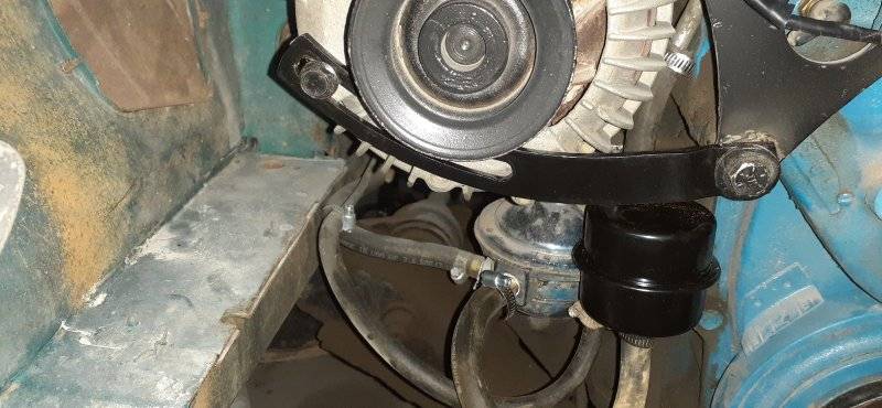

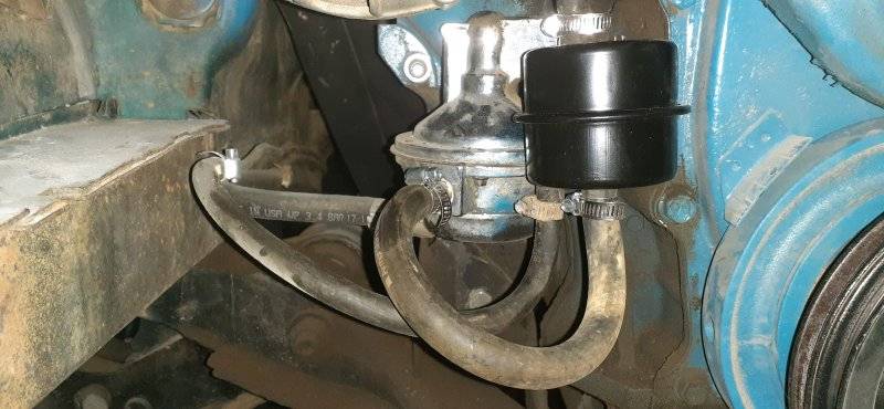

I've got a reference book (Charger, RR, & Super Bee Restoration Guide, by Paul Herd, 1994) says the 68-69 HP 440s all got the vapor separator and return line, the lower performance 440s (station wagon, base New Yorker) didn't. This seems consistent with the fact the HP versions got other upgrades as well. My friend Dave Miller's survivor '68 GTX, built 2-68 at Lynch Road, 440 automatic, also had the vapor separator and return line.Not in all cases. My 4-23-68 SPD automatic R/T came with 5/16 fuel line, vapor return, and 3/8 sender w/return. The original lines still had the factory undercoating, but I replaced it with 3/8 to match the sender, which wasn't done originally.
