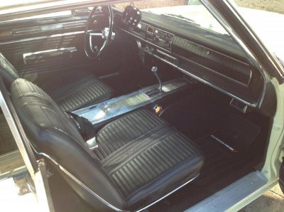

im looking at a car for sale this weekend, low mileage and says all original but the interior looks original but has the bucket seat console and the bucket seats have the middle 1" wide or so scroll looking pattern in middle of seat. I have only seen that in belvederes. am I wrong? was this an option interior? I have even looked at year one and they didn't show it. any help guys? not sure this would make or break the sale but id like to know if original or not, may effect price.
see pic

dont know about options, but I have the same 67 coronet 500 and mine dont have that, the seams go straight across. would like to see some pictures of the car.
That is not correct, it is from a Plymouth. Doesn't make it a bad car though. That looks like a nice car. It was talked about else where and got thumbs up from everyone.

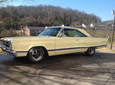

Seat covers are from a 67 Satellite or GTX.
The wheel centers are not correct either. Are they "Magnum 500" centers? Those would be aftermarket, but possibly period correct. Gramma must have liked shiny chrome wheels.
...and door jamb switch for dome light has been painted.
...with overspray on A pillar trim.
front seats are western scroll pattern familiar to satellite and GTX in 67. I have a 67 R/T and like that pattern better than the stock 500/R/T cover. Rear seat should be stock though as the satellite and GTX had a large center emblem not familiar or fitting to a 500?r/t car
Seats are Sat. for sure! What does the rear seat look like? I don't know about the wheels! I know they were available as an option for the R/T, The 500? Not sure if the 273 was still available in 67 either! Still not a bad ride!

back seat is identical to fronts, same scroll and looks well aged etc... if someone changed them out it must have been 20+ years ago...I dunno. or could someone order it like that from factory? as a special request? just weird. not a big deal but just weird.
yeah car has had one repaint.
the center caps have three little red triangle looking thingys...not sure what is "correct" for these.
they are 14's that's all I know. could be fords?

Hmmm, both cars that came with that back seat scroll work (Sat and GTX) had the fiberglass seat fascia with the "faux" bucket beackrest look- NOT the standard flat across seat back..
Did someone make that back seat cover??? Got a pic of that?

It's supposed to have a white interior (P6W)
well...white and black...that explains the seats.
Also looks like white vinyl top.
At least for 66-67 cars you don't have to do body work to add or remove a vinyl top.

so aslong as these seats fit and look factory and in great shape then I shouldn't have an issue with these changes to the car. it already has one repaint, someone put headers on it and the different wheels...so its not 100% stock anyways.
so probably it had white seats, with white and black carpet at bottom door panels...
