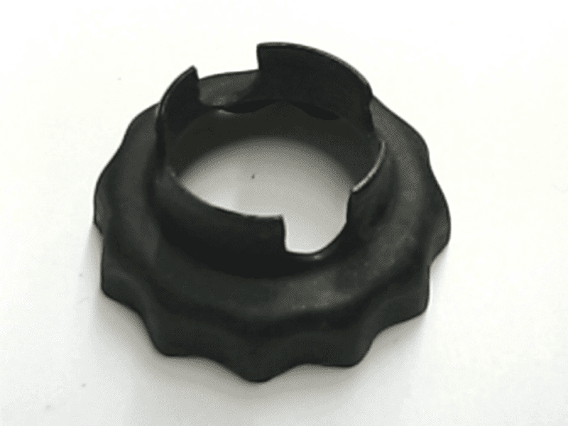

If you're using a nut with slots, you can encounter the problem you described. That's why Chrysler used these stamped sheetmetal locks to fit over standard nuts, it's easier to get close to the desired location.
