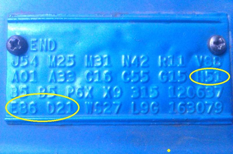

440 4 speed with H51 code for AC

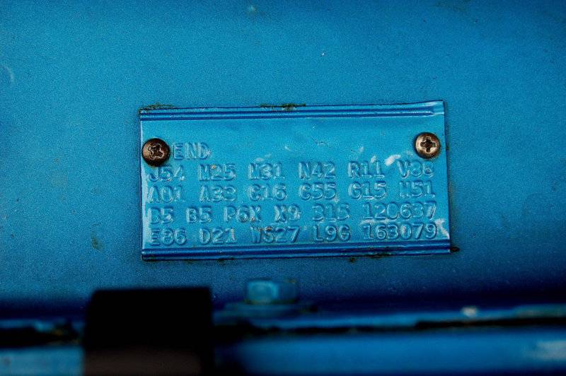

Better pic. Pulled it off the internet.. Not mine.
On the 69 Coronet R/T fender tag....Checked with someone who's got allot more knowledge about codes & tags & broadcast sheets than I do... His comment...
lots of mistakes, J54 & N42 are the humorous ones
& not in a good way
it also has a restamped engine VIN - was on eBay? or other September 2012, May 2013 & July 2014
lots of mistakes, J54 & N42 are the humorous ones View attachment 813246 & not in a good way
VIN to SPD is way off. Bad tag and doesn’t prove the original question for which the answer is still “no”.
