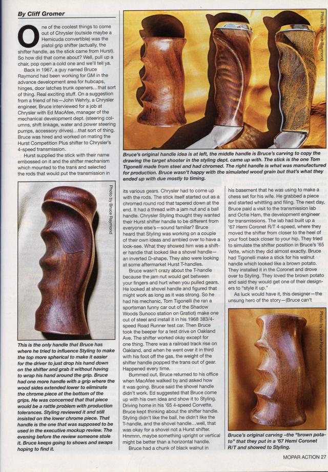

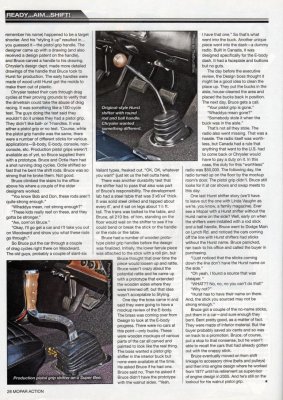

I don't know if you're able to read this magazine text, it's the story of the Pistol Grip shifters from Mopar Action Aug. 2012.

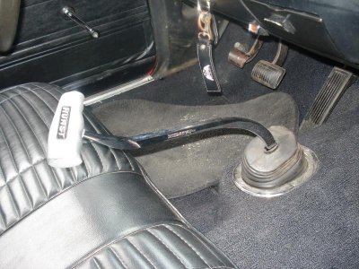

This line interested me. I have a long stick that curves a bit (yup I said it!) and my throw is really long.... I've heard about cutting each of the throw rods a bit shorter but seems like a lot of guesswork.
Here's a pic of my curved shaft :)

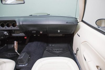

The 70 Cuda 383 4spd car I just bought has a shifter like this Cuda. Note No Console.

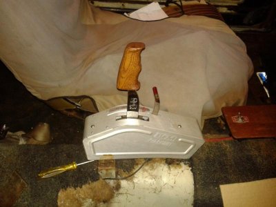

Not fair the autos didn't get to play with those!
So screw it had Duncan make me one. Feels good in the hand :)

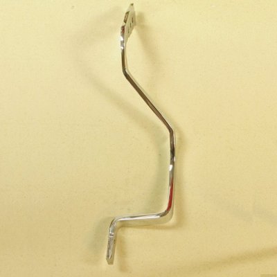

Tallhair, I thought the one on the far right(bottom?) with the big bend was for console.
Yes, you are correct. The with console handle has the much bigger bend. The pic below is a 1970 B body handle with console minus the grip.

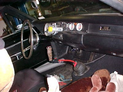

The pistol grip in the B,body has a diferent mech than the other's. The arm's are LONGER to make the throw shorter.
If you take a standerd hurst mech and put a pistol crip handle on it you will be swinging a long shot from gear to gear !
Not to mention, SMASHING your knuckles on the hard plastic dash pad, power shifting, from 2nd to 3rd!!
