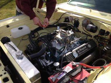

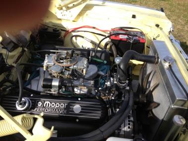

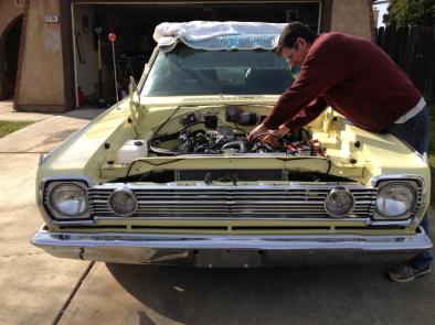

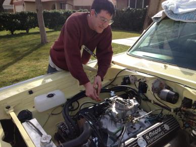

001.jpg002.jpg003.jpg005.jpg006.jpgOK...While my Brother is working on the Video issue, here are some pics of the Engine and driving run yesterday. It does sound "AWESOMELY WICKED". Check out in the first pic the 2 H2O marks from the exhaust on the driveway. That right there is an indication that I got a great one here as the final exhaust product when an engine is tuned correctly is H2O. I still have a "KNOCK" but it is not the Engine after repeated inspections, valve and lifter checks, etc. Most likely it is in the Transmission...not really sure there...but the tranny isn't working correctly. Drive, 2, and 1 all slip. Reverse is smooth and firm. Park works as advertised and no issues while in Neutral. The "KNOCKING" quiets down when the tranny is put into Reverse. I had the tranny re-built and set up for "Storage a number of years ago when I first got this project. Most likely that is the culprit for the Knocking which reverberates through the engine and is distinct. I checked the flex plate and mounting nuts and they are all good. Don't know about the flex plate to crank bolts but when I rebuilt the engine I definitely made sure they were torqued and tight. Tread Locker was used on both. But I have entered into a new phase now as it is running and the short drive tells me that I am moving in the right direction and I just have to fine tune and fix these slight adjustments. That's my best friend and Bro doing the tuning. He has a Midas touch when it comes to dialing it in...:headbang: So where is the "DDDDAAAAWWWWGGGG" when I need him...cr8crshr/Tuck:blob1::blob1::blob1::blob1::blob1::blob1::blob1::blob1::blob1:
