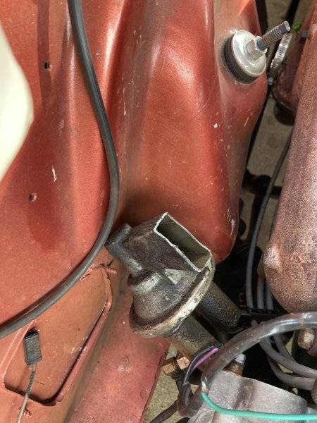

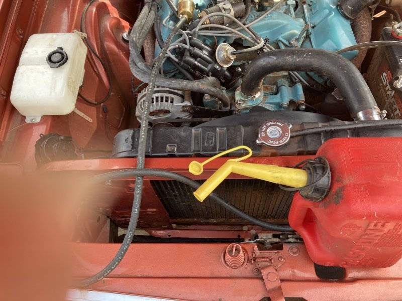

Two blocks away from my house, my car died. It felt like I ran out of gas, but according to the fuel gauge, I had some in the car, although not much. I walked home, jumped in my daily driver, went and got gas, and poured it in the tank. The engine would run with fuel poured down the carb, but would not stay running. That made it obvious that the problem was with fuel. I grabbed the rubber fuel supply hose to the pump only to find that the pump had cracked off. I hated to call a tow truck to Tow the car two blocks. I went back home and took a 1 gallon plastic, gasoline, can and I attached fuel line to the air vent And then attached the other end of the hose to the inlet of the gas filter. By blowing into the spout of the gas, can I was able to fill the gas filter and carb bowl. I had to fill the filter two more times, but I got it home.

:BangHead: :BangHead:Never seen that happen before.
Where there’s a will there’s a way I always say. Way to get it done!
:thumbsup:
Nicely done. I've never seen a pump break off like that. Dare I guess the country of origin.

Cracked. No, busted in two.
Put me in as another who's never seen nothing like that in over half a century.

To answer some earlier questions, the original that cracked has been on the car, five or six years. It was brand new when it was installed. You can see in this photo where it was made. I don’t remember the manufacturer
