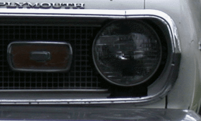

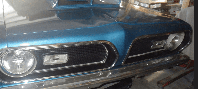

I just used that to piece in a couple inches of MIA plastic for my left surround, reattached the top at the cracked chrome trim, and filled miscellaneous cracks in both sides. It was also suggested I open up the mounting holes for shrinkage of the plastic surrounds to fit on the outer chrome trim. So far so good...
We'll see how long it lasts. These old plastic parts crack just looking at them a certain way.
