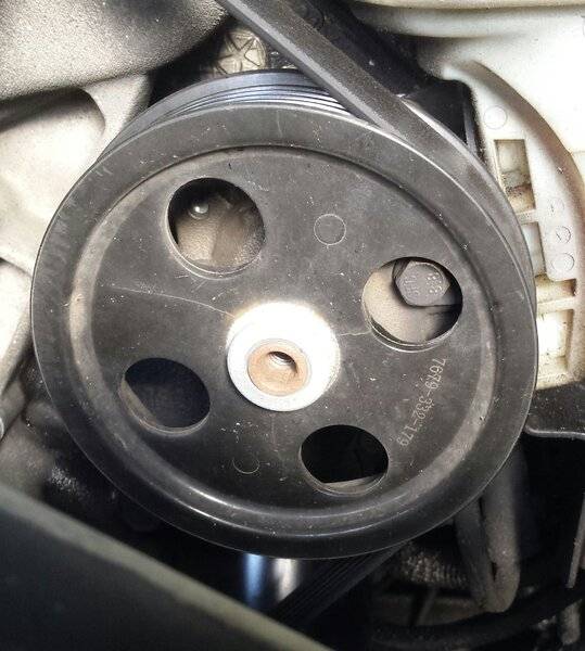

Discovered this yesterday when swapping out my radiator.
Good catch
That would have caused some damage.

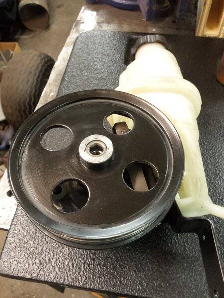

You're right. Can't help much on the details it was purchased on ebay a long time ago. But I did keep my old pump. So I'm hoping that I can put my steel pulley on this Chinese pump. And it's a lesson learned. By going the cheap route. Pretty much a heads up post. My apologies.

I don't know if it will fit. But the pump works flawlessly. I'm positive that I can make it work. I have a machine shop at work if the shaft and pulley don't exactly match up...
the Chinese shaft was .042" smaller.. bored out the pulley and pressed in and tack welded a 4130 chromoly bushing and bored it to press fit the shaft.
