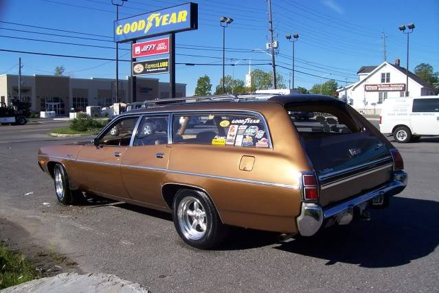

I have some left overs with offset washer how many do you need and what thread left or right?
Thanks for offer bigmanjbmopar, I already ordered a complete set before I saw your post.. Your car looks great, what brand and size wheels are those? Thanks again...
