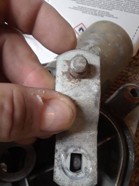

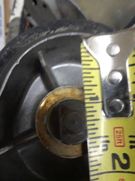

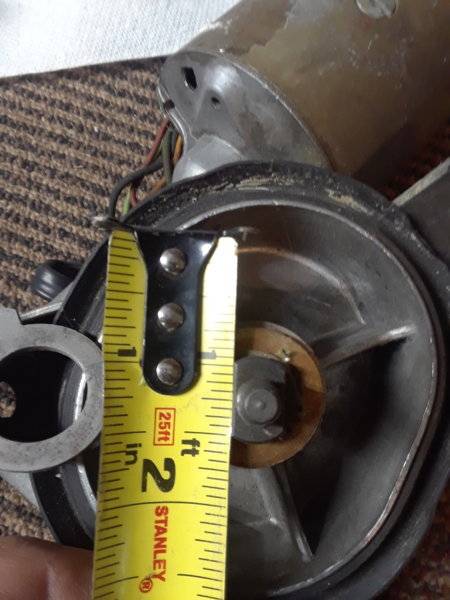

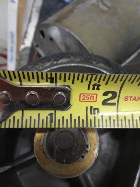

Not sure if they are the same but I have one that was for a 2spd motor
I think I have one of those it has a smaller hole for the shaft mount that's my last resort is fabbing that one but not sure if the length is right

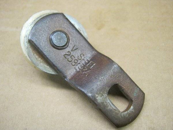

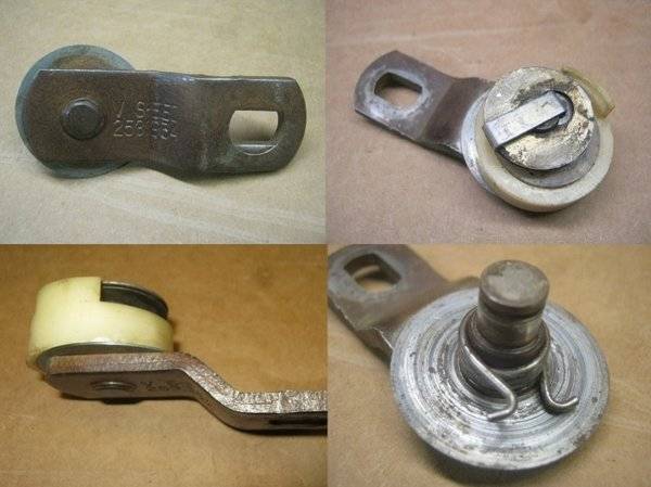

2 speed is not the same. I might have the 3 spd. you need. I'll check. Not cheap tho. 273 #. If I remember.
Not for sale but here are pics for reference.
Info:
1967-68 B Body 3 speed/Variable speed wiper motor crank arm part #2580934. Along with the crank arm this assembly has a 2 piece plastic bushing, spring washer, shaft spring and secure clip.

Thanks for the reference, I have some of the parts off the other arm I have so getting closer, this is probably one of the hardest parts to find for me that my car was missing.
