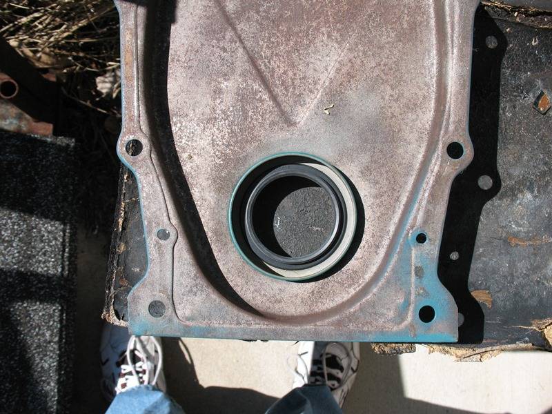

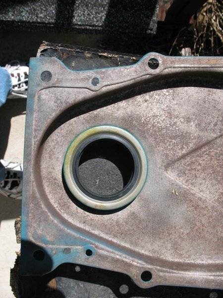

Which way does this seal go? I think picture 2, but not positive.
Picture 2 is correct. The open part of the (any) seal goes to the fluid side. Also, I fill the gap will petroleum jelly or other firm lube, to aid seat in.
That is a great idea! I've learned something new today. Thanks much!
