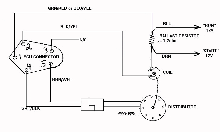

Was your electronic conversion a magnetic pick-up with a reluctor wheel? Did you have to set the gap between the wheel spokes and the pick-up? If so, maybe it slipped.
Good day guys :Its true in both. When you are in the start position, your ballast is bypassed completely. The coil gets a full 12V sent to it when cranking and bypasses the ballast then goes through it once in the run position.

This is my first time joining your chat line and it looks amazing. I have a 1970 440 six pack superbee and it is having the same issue. Started it one day next day wouldn't catch at all, it seems it wants to go but soon as I let off on the key it stops.
Would this be the same possible issue that Tony is having? I talking to other guys it seems that 6 pack cars are renowned for hard starting not sure if this is a fact. Hope you guys can help me out.
Mine turned oput to be a loose bulkhead connector...center one.I replaced the ballast but no joy,
Hay Jeff this was the same issue with mine.Mine turned oput to be a loose bulkhead connector...center one.
