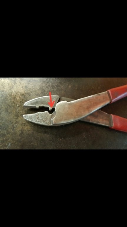

The ones I use are Klines. There are some knock offs that can be just as good. I've used many and these are the best. They do a perfect crimp!
In this picture, the arrow is where you place the terminal end, butt connector or almost any size end that requires a good crimp...
