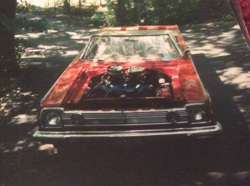

I use these from Summit. No name brand with no lettering. I believe 9” diameter.
I have a hood scoop; probably won’t work with stock hood.
