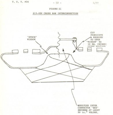

i was looking at an old direct connection engine manual and they show what looks like a factory interconnection. the illustration in the manual makes reference to the s/s racers increasing the cross sectional area for what i believe to be more top end power. the old long rams used an interconnection/balance tube. i don't think the old edelbrock type log rams had any interconnection or balance tube.
Interesting...I was looking at my DC Bulletin #34 and it definitely shows an interconnection on the factory RB crossram. Here's the diagram: As to 1962polara, maybe the connection is internal and not visible from the underside, since they say you need to cut and fab if you want to increase the size of the connection. I guess a boroscope is in my future...
pretty sure the hump/raised part between the two plenums is the interconnection; not visible from the inside.

There you go; always the voice of reason, lew. Different mirror, stronger light and that "hump" (approx. 3'4"H X 2"W) is definitely an interconnection from one carburetor plenum to the other. Didn't see it at the first look-see because it's on the roof of the manifold, inside. Will be ordering the Fuel Control Center and the GO EFI 2X4 625HP Dual Quad N/A set-up tomorrow. Thanks again for everyone's input, and especially to lewtot.
