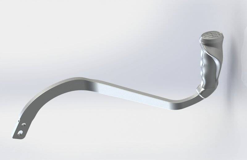

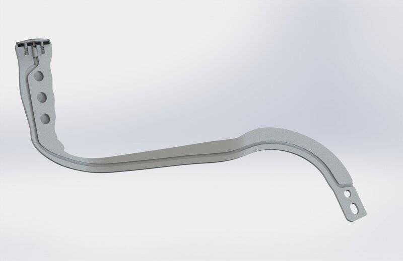

Having this custom made for my 69 charger 6speed

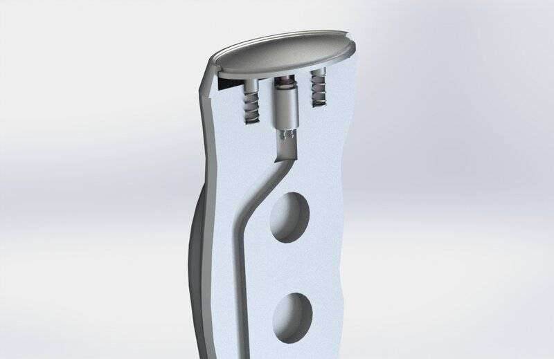

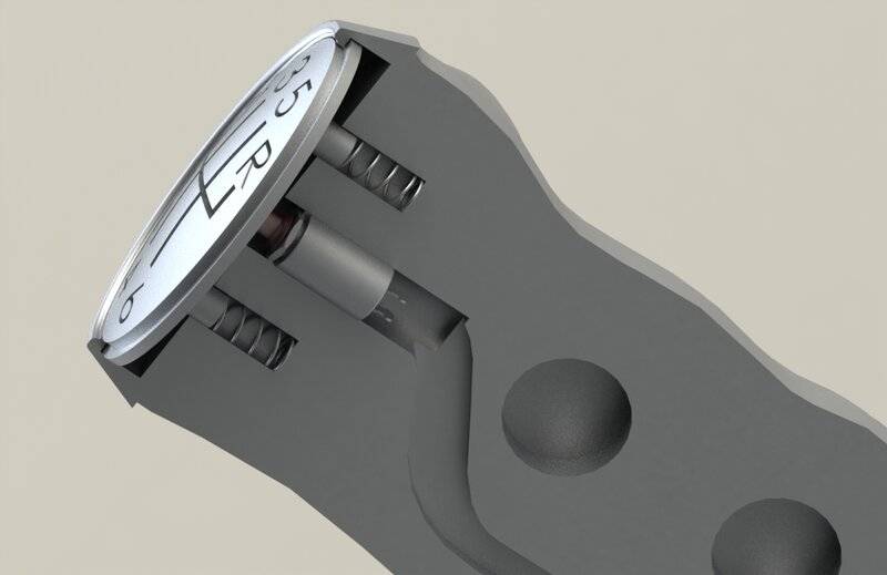

Machined out of aluminum 2 piece to get the wires through the middle

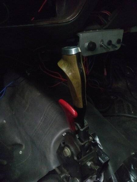

Cool! With todays technology.... "Alexa, line lock on" ! But it don't work from my flip phone either...
Reverse lock out. Pull up and it won't go. Into reverse.
Helps also on the 1-2 shift if you pull towards the left sometimes it'll catch the reverse gate and cause a missed shift.
It's a Hurst super shifter 3
