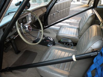

well the time has come to redo my rollcage in my 65 hemi belvedere.
when i bought the car the guy must have been 5'5 cuz the front halo bar is so low,it hits me in the eyes when i'm looking at the tree.plus it is mild steel, so i'm cutting it out and going for a nice new CM cage with a funny car cage too.
i'll have pics of the transformation.
i never like the cage to begin with but it passed certification but now its time to go new school. pics to follow.
