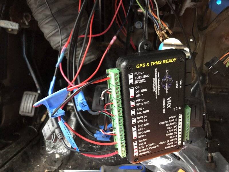

Second best thing we put in the car. Lots of wire, just make sure to have your readers available. It even matches the radio.
34EBA8C3-DB54-44A3-BA97-7A7A17C7B5CE.jpeg 278CBF74-A3AC-4826-AED6-7BAEE5E818E1.jpeg
Mine is an a/c car so everything to the right of the steering column is ram packed already. Pic shows center between e brake and steering column. Build the box hanging down about half way to the floor. This gives working and reading room for assembly then roll the wiring around the box and up. Knowing you will be back at some time, it will drop down and can be serviced.

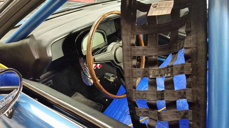

Very cool. Looks great at night. I put a Racepak digital dash in my street/race Challenger. I didn't really want to but the dash has 6 gages per screen with 4 screens that I can flip through. 24 gages total. Needed with every system that I am data logging and monitoring.
