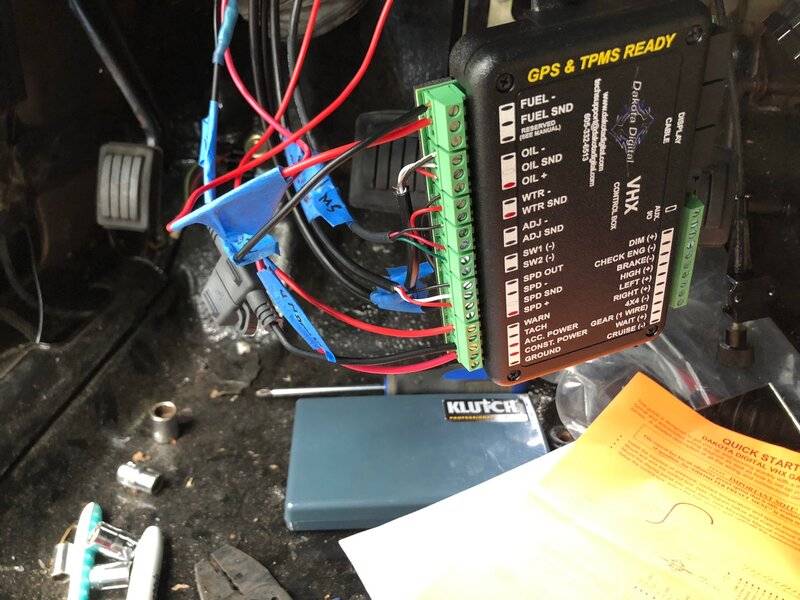

I would put it at 6 hrs first time plus 2 hrs book time. Second attempt, 4 hours. Steering wheel needs to drop . Do you know how to unbutton the factory dash. I do now. You need 12+ constant, 12+ ignition, ground to battery, ground wire all the way back to the fuel sender. Bring your readers also.
