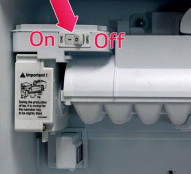

On your Ice maker, there should be some switch or IR beam/detector to know when the door is open. Might want to check that that works?
