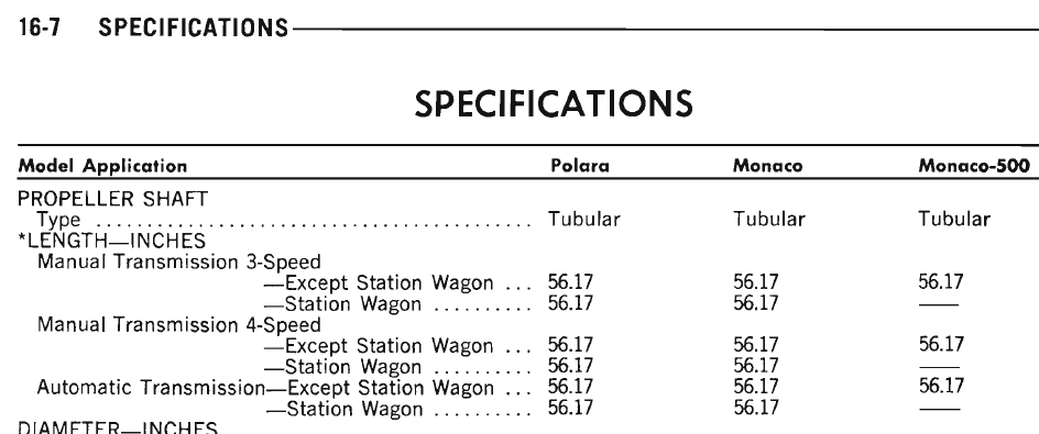

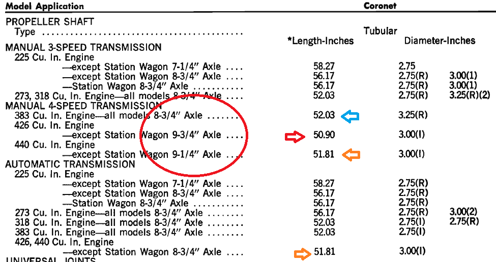

I was looking in my ’67 Dodge FSM (Factory Service Manual) and ran across this in the propeller shaft section.
I noticed three different propeller shaft lengths (for the Dodge B-body) for 4-speeds:
383 w/8-3/4” (blue arrow) 52.03”
426 w/9-3/4” (red arrow) 50.90”
440 w/9-1/4” (orange arrow) 51.81” (which also is same length for 426, 440 automatic with 8-3/4”).
That got me wondering about the 9-1/4” differential (My Question #1).
It also made me wonder why driveshaft lengths are different between them (My Question #2).

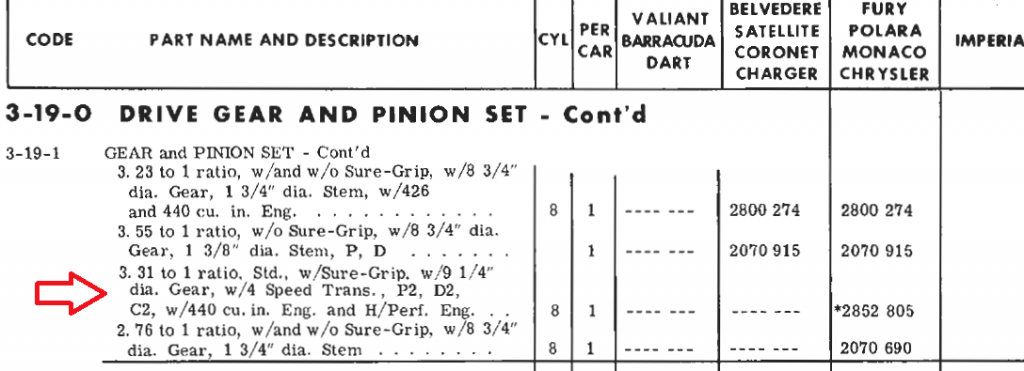

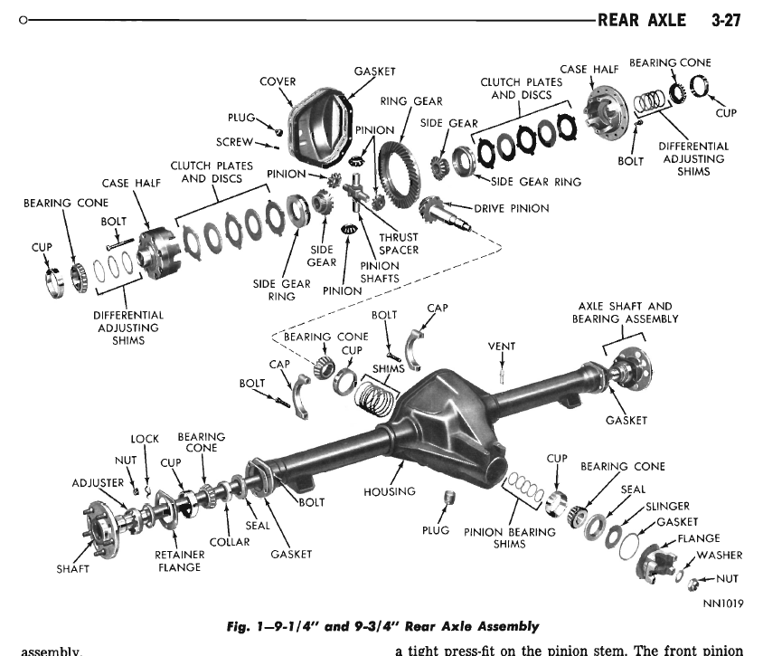

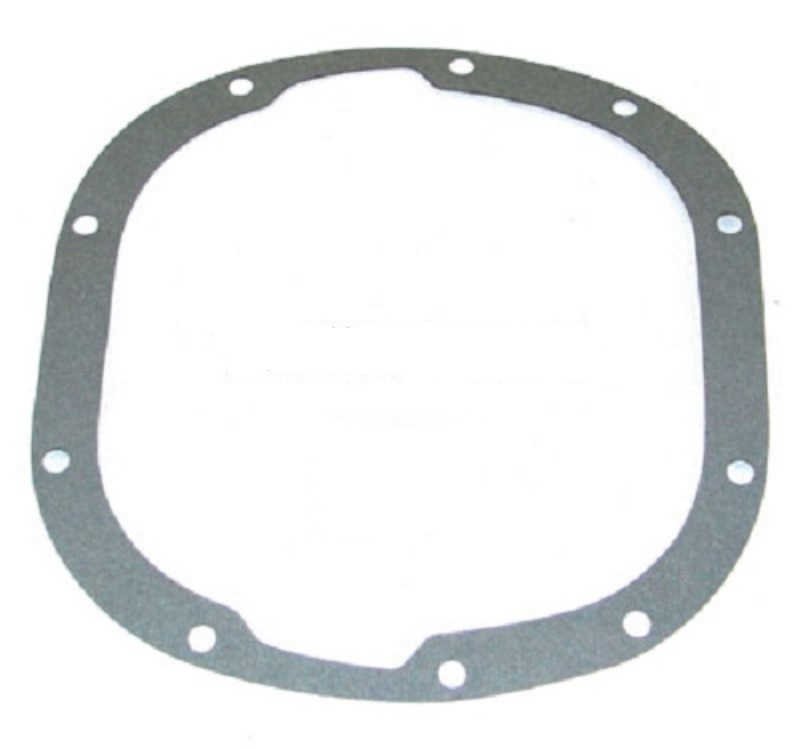

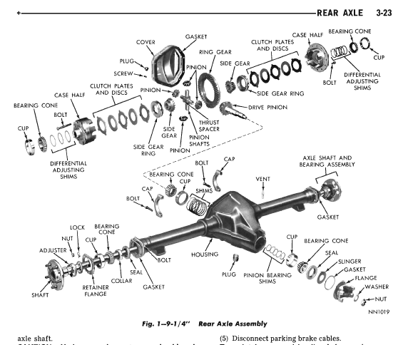

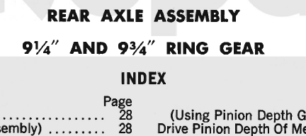

Then, I went to differential section of same book and took these two pictures.
Google research led me to http://www.forcbodiesonly.com/mopar-forum
Where I found out the 9-1/4” is actually a Dana 53 (also used in older Jeeps).
C-bodies used the Dana 53 in ’67-68 (only) behind 440 HP 4-speeds (only).
It appears (from what I can read about), the same Dana 53 was also used in ’67 (and maybe ’68’s ???) B-bodies with 440 4-speeds, whereas the 426 4-speed cars got the Dana 60.
Is this correct? (My Question #1).
Has anyone ever ran across a 9-1/4” in a ’67 B-body (or in ’68) (My Question 1a)?

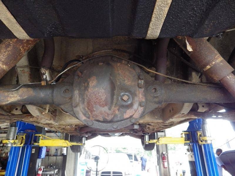

Link to Dana 53 in a C-body http://www.forcbodiesonly.com/mopar-forum/threads/68-440-4-speed-rear-end.23307/
(A picture from the above link)
A Dana 60 (pic swiped from internet)
The Dana 53’s has been confirmed in C-bodies and it appears should also be in B-bodies (and no, not the 9-1/4” corporate axle version).

According to my ’67 C-body FSM and my ’67 parts manual, the propeller shaft length is the same between 8-3/4” and Dana 53.
Why is it not the same length between same on B-body (Auto or 4-speed as well as 8-3/4” and 9-1/4”)? (My Question #2).

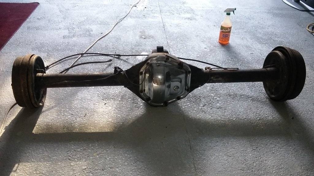

Hey that's my 60 and garage floor!
Perches are welded, should be installed this week.
PS please PM me for address to send royalty payments. :D

I'm jealous – for that is a mighty fine looking differential you have there.
If you want, I can take the picture down?
The only Dana I’ve ever owned is a Dana 80, that’s in my Diesel pickup – which I think it weighs in as much as what one of today’s jelly beans total weight, is (excluding driver) . . .
"I'm jealous – for that is a mighty fine looking differential you have there.
The only Dana I’ve ever owned is a Dana 80, that’s in my Diesel pickup – which I think it weighs in as much as what one of today’s jelly beans total weight, is (excluding driver) . . ."
Thanks, my diff is just a little above average but I'm not ashamed.
You can leave the pic up.
Your Dana 80 is impressive, but really, how many cars can you actually fit it in?:rolleyes:
. . . but really, how many cars can you actually fit it in?:rolleyes:
I think the question should be: How many of today’s cars, could my Dana 80 make, if melted down?
Each of my rear brake drums weight as much as I do.

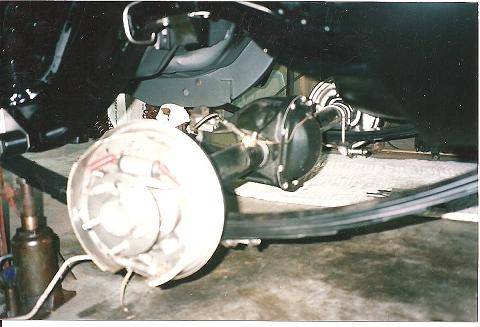

This one supposedly came out of a 66 Satellite,no reason to doubt the fellow I got it from,3.31 sure grip,bolted right into my 62 Savoy wagon,no need to change anything.
