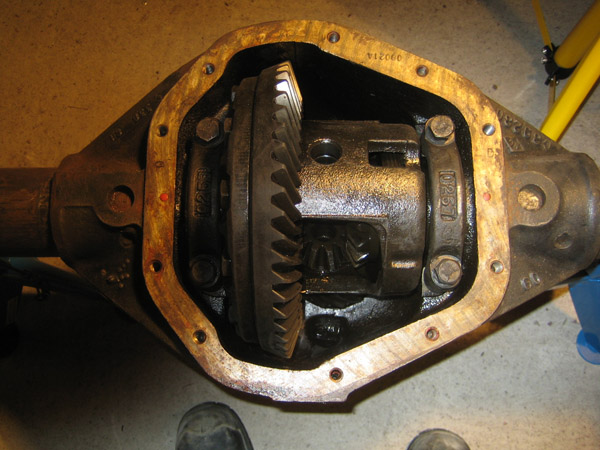

The differential (see pic) is it a Trak-Lock and will it work in a street car ?

The axles should be the same O.D. at 1.50"....as for the Trak Lock...I think they are worthless! I have one in my 2000 Durango and it started chattering at 30K miles. I don't remember what the book says to service them at but the dealership said 20K. The book said a lot longer than that. Anyways, I drained the old oil and cleaned out the bottom of the housing. It had a lot of gunk in it. New oil and Trak Lock additive and it was chattering like crazy 5k miles later (5000 miles, not klicks). Another oil change and this time I added half bottle of STP oil treatment. Been working like a charm ever since and it has 80k miles on it now. Still locks up too. My nephew has a Dana 60 in his pickup with one and it's wasted but it does have 280k miles on it...
