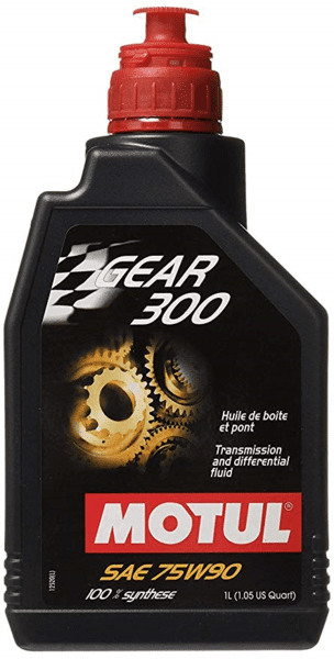

synthetic or regular 75w90w

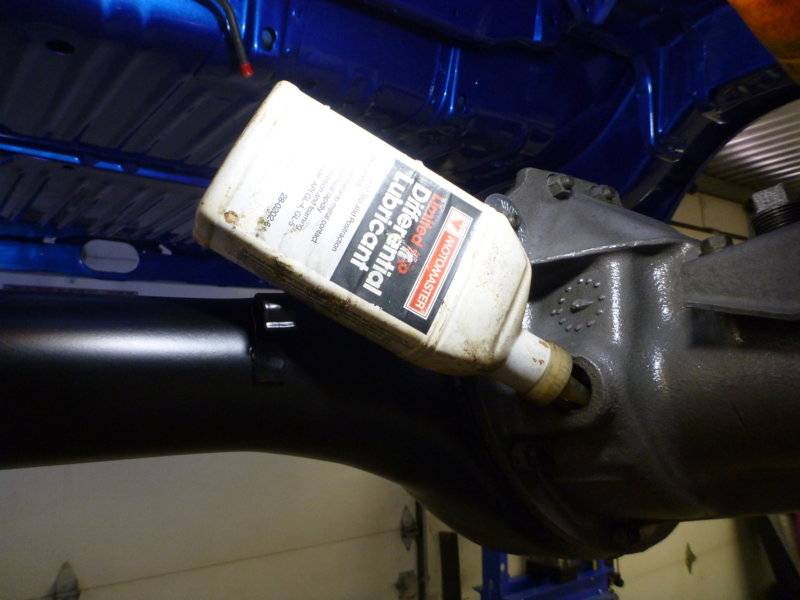

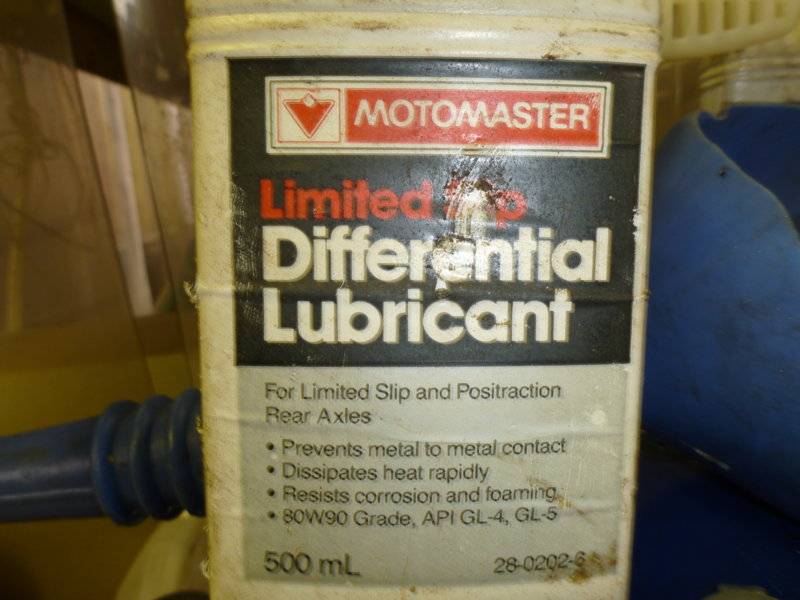

I just hung onto some real 40 year old stuff, wish I'd bought a few cases as I'm out!

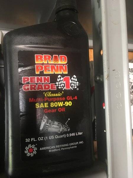

I use this in both the Dana and transmission. (Sure grip additive in the rear)
