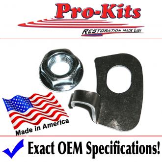

You using the nut shown? Also you sitting the axles before adjusting? By sitting I mean pushing left axle tight to the right and then adjusting the left axle clearance to the retainer. You have to take the lock loss to do this and them put it back on when done.
