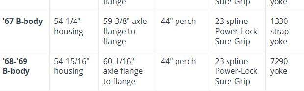

Here's a chart of Dana widths. Chart says 67 housing 11/16" narrower than a 68. So you cut housing to 67 width and you'd need to cut 11/32" off each axle so you can set side play, unless you use green bearings. Check my calculations!!
If you cut a 1/2" off axles and used tapered/stock bearings you'd never be able to set axle side play.

If you have a powerlock and remove the thrush button that you don't need with GBearings you might not need to cut anything? I wouldn't cut a 1/2". That 11/32" cut would allow you to go back to tapered axle bearings. Cutting axles could be checked in a mock up or last minute thing.

Fran.. the 1/2” number was just a number I tossed out there because when I made my post I knew the 67 Dana was about 3/4” shorter overall. I would not take 1/2” off each. Like you said above, 11/32 off each should suffice.
