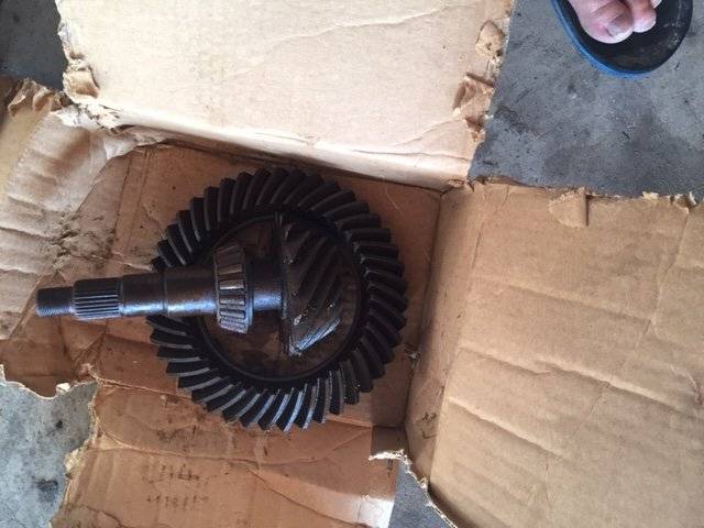

I got these gears a while ago, the ring is 43 teeth and the pinion is 15 which makes it in my book 2.86
My understanding is the lowest is 3.54, which i have one off
Is this a truck ratio or something
The ratio should be stamped into the outer part of the ring gear.
Call me crazy, but that ring gear doesn't look like it is 10.75" dia. Maybe an optical illusion due to your gargantuan foot... :lol:
Well, its not a nine inch ford. Is it aftermarket or oem mopar? Does it have a brand name on it? Maybe a 9 1/4. It sure aint a dana 60. Dana 60 is 9 3/4.
I just realized you're in NZ. If those are native gears, I've got no clue, not familiar with Aussie rear ends. Maybe Google a part# from the ring gear?
You may have a pinion gear from one type of rear and a ring from something else?.
