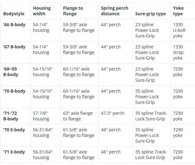

I'm positive there were no dana60s stock in 64, so yours could be anything,stock later b-body, stock a body from 68 hemi cuda(HIGHLY unlikely) truck rear, or a narrowed version of any of those. You'll just have to get the wheels off and measure. Do you want wheel mounting"drum-to-drum" or backing plate flange to flange? I dont know distance from drum face to flange,but im sure somebody here does. It would help to know what size drums, or discs.

Have 1.5 to 2" spring clearance and 3/4" to quarter clearance . INMO no way with that 3.75 bspace. My Dana is a 67 I believe maybe a 68. Has a 1330 u-joint which is a 66/67 yoke.
Maybe an offset shackle kit and 5 or 5.25 b space wheel, maybe. MO lot of maybes in there.
A 69 Dana is wider than my 66/67.

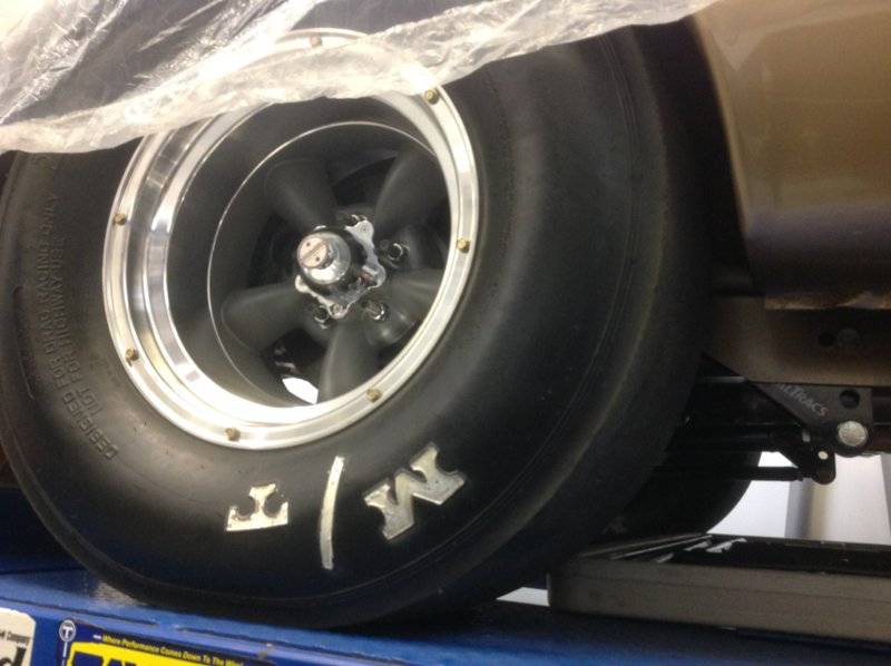

What you describe is exactly what my car has. I can't recall exactly what the width is but I can get it. My tubs are smack against the frame rails, 3.375 BS on the ET Torque thrusts.

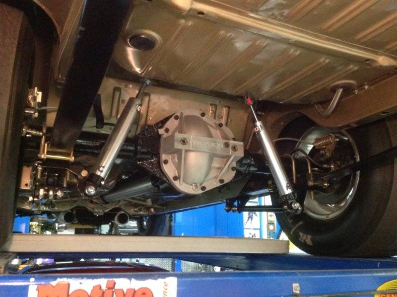

I grabbed a measurement this morning for you. My housing is 49" end to end. To the outside edge of my leafs is 39". And there is 5" from the edge of each leaf to the housing flange on each side.

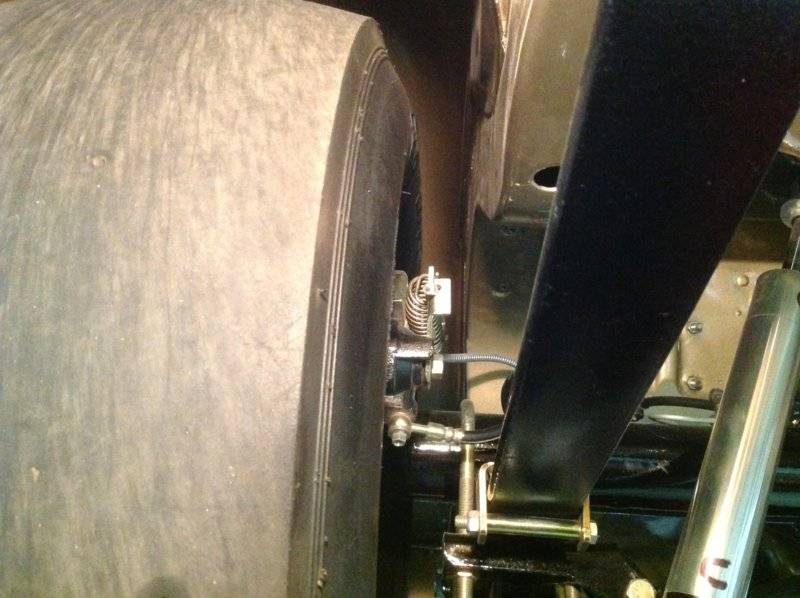

I have 11.5 X 29.5 MT's mounted on the 15 X 10 Torque Thrusts with the 3.375 BS and I have about 2.5" of room between the inner tub and inner tire sidewall. Space between the outer tire sidewall and outer wheel lip / tub is about .750". I also have 15 X 12's with a 5.5 BS that fits up in real nice.
Approx. 2.5" between the inner tub and sidewall. Tire cross section is 13.6"
Rims that you are referring to. My front ledge is moved ahead flush to the tub.
Dana. 49" flange to flange. Approx. 54" to outside face of rotors.

thanks for the measurements!! exactly what i got except im using drum brakes but i dont think that will affect the flange to flange measurement i need since the drum is not as thick as a rotor for disc brake is, thanks so much sir
You're welcome. It will be the same. I converted to disc from drum. Nothing changes.
