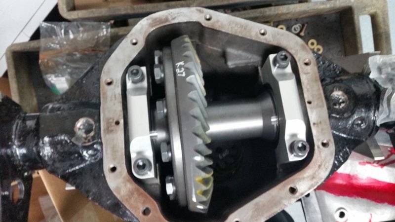

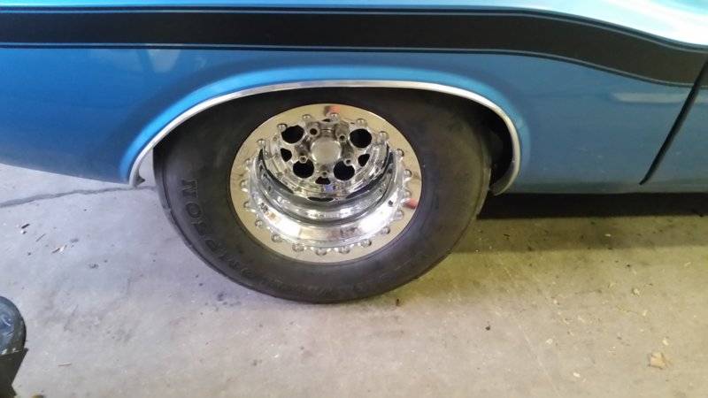

I did all mine myself. I narrowed an old 1 ton truck rear end. Not a stock set up so the snubber wasn't necessary. I am running Caltracs. Just finished the assembly with a spool and 40 spline gun drilled axles.
View attachment 843942 View attachment 843943
Looks great, I'm doing the same, bought a 60 housing out of a 3/4 ton truck, Just dropped off the housing at the sandblaster. Going to paint it and put it away in the garage till next Spring. Planning on narrowing the housing 47.75 inches flange to flange to work in a mini-tubbed 66 Coronet. Going to run a spool also.
